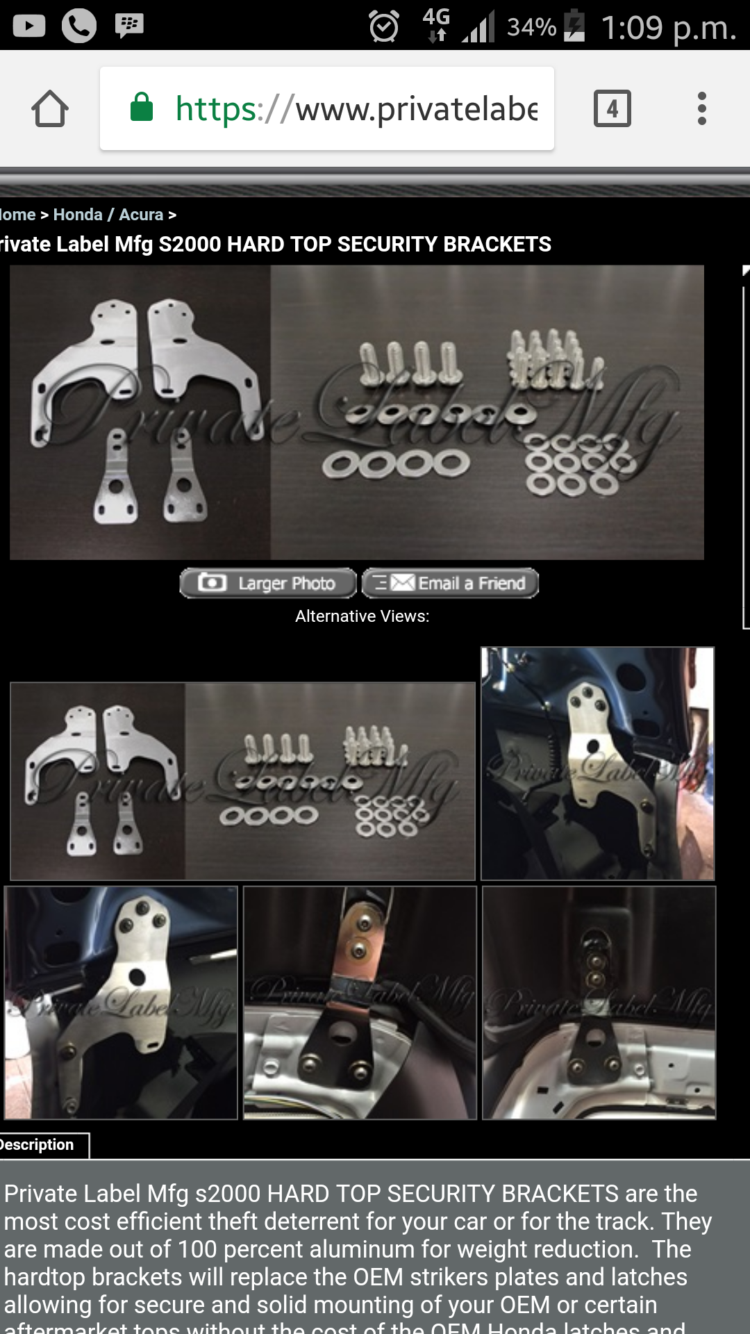

Default Hardtop brackets PLM
I just bought these with the OEM hard top .
has anyone installed a Hardtop with these brackets???
any one has the step by step instructions on how to fit these please.
want to put the hardtop on this weekend. Any help is greatly appreciated.

I have hardware like this installed in my track car. It is very simple. Remove the existing front catcher and rear plastic side pieces. Check to see what bolts need to be removed from the rear by holding the bracket in the position shown in your picture. and remove them. Now set the top on the car and install the brackets, leaving the bolts one side of each bracket loose. Then push the top forward form the rear, and tighten the fronts. The push down and tighten the rears.

Sounds simple enough. Can you please post a pic of what a properly seated top with these brackets looks like . From inside and outside and near the windows. Just want to see what it looks like .
