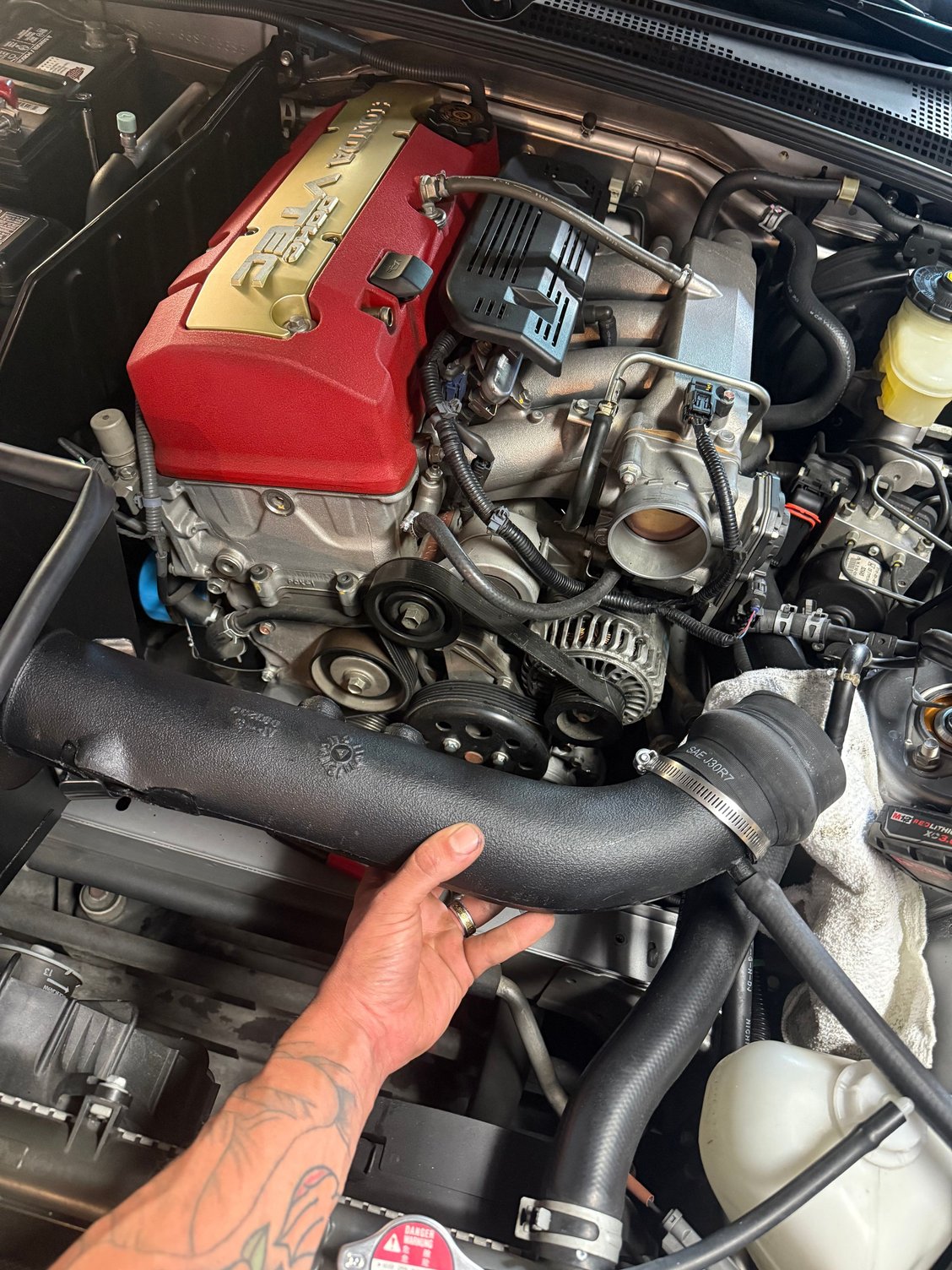

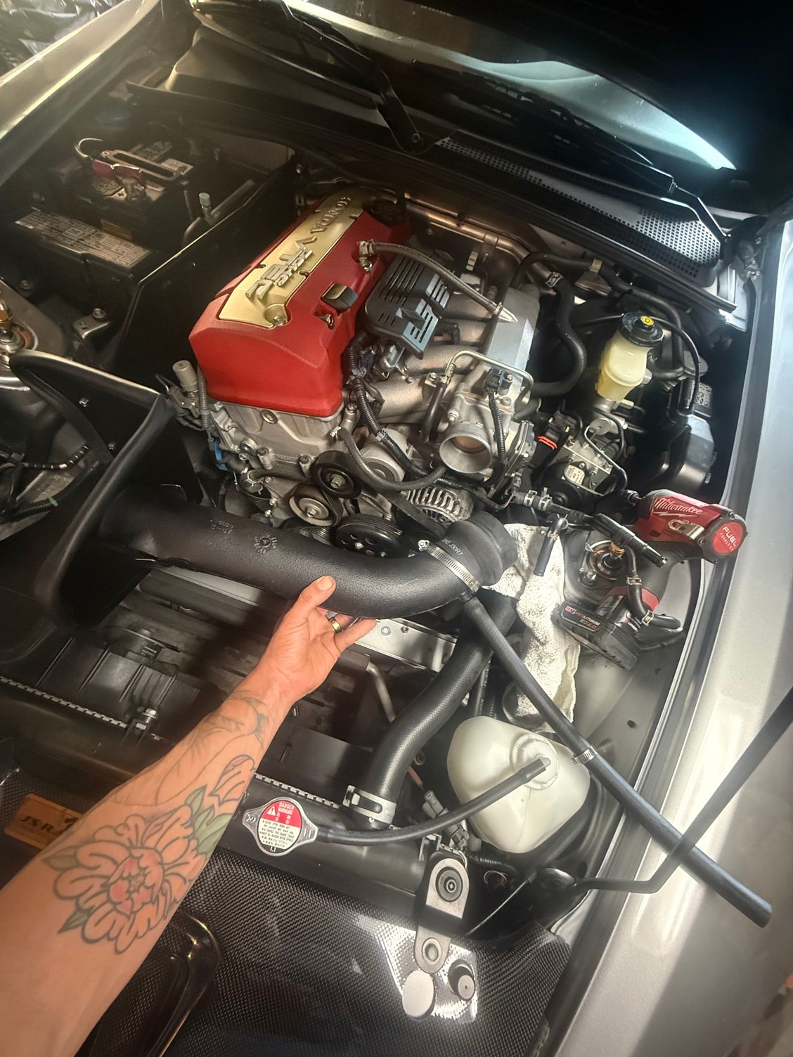

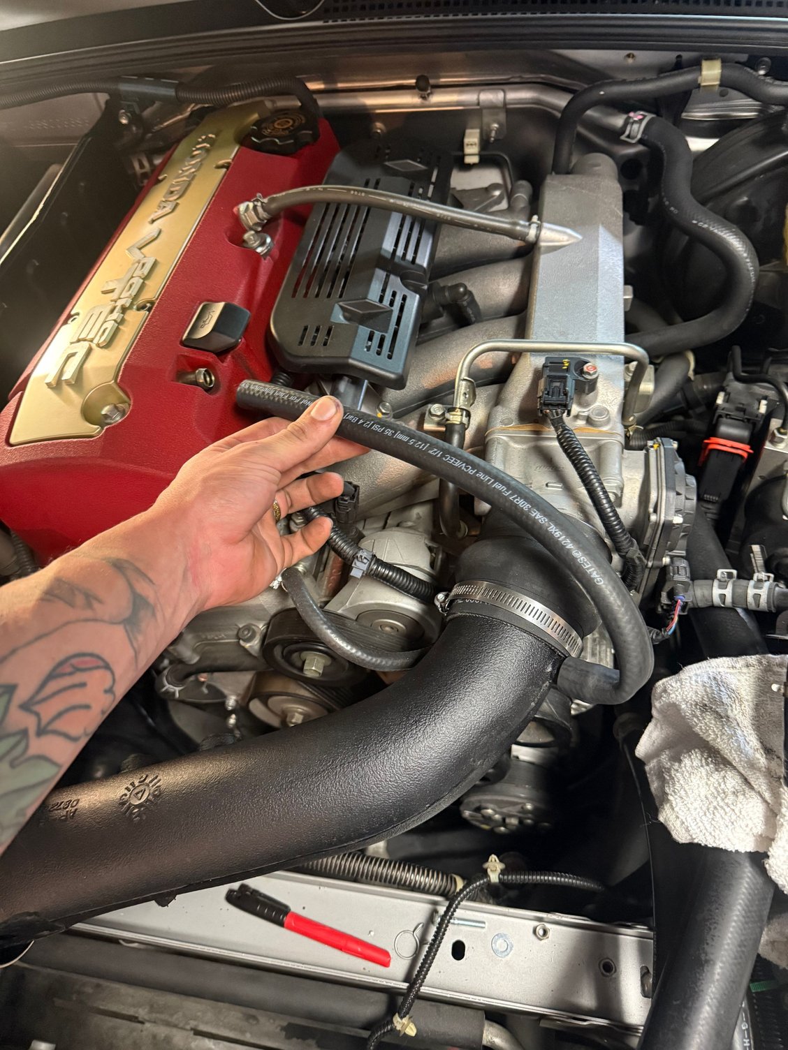

was hoping someone could help me out, I recently purchased a k&n intake, and I'm thinking it's the wrong intake arm. Mine comes out at more of a 45 angle, logo on bottom side, every one l've seen in video/pics looks different.

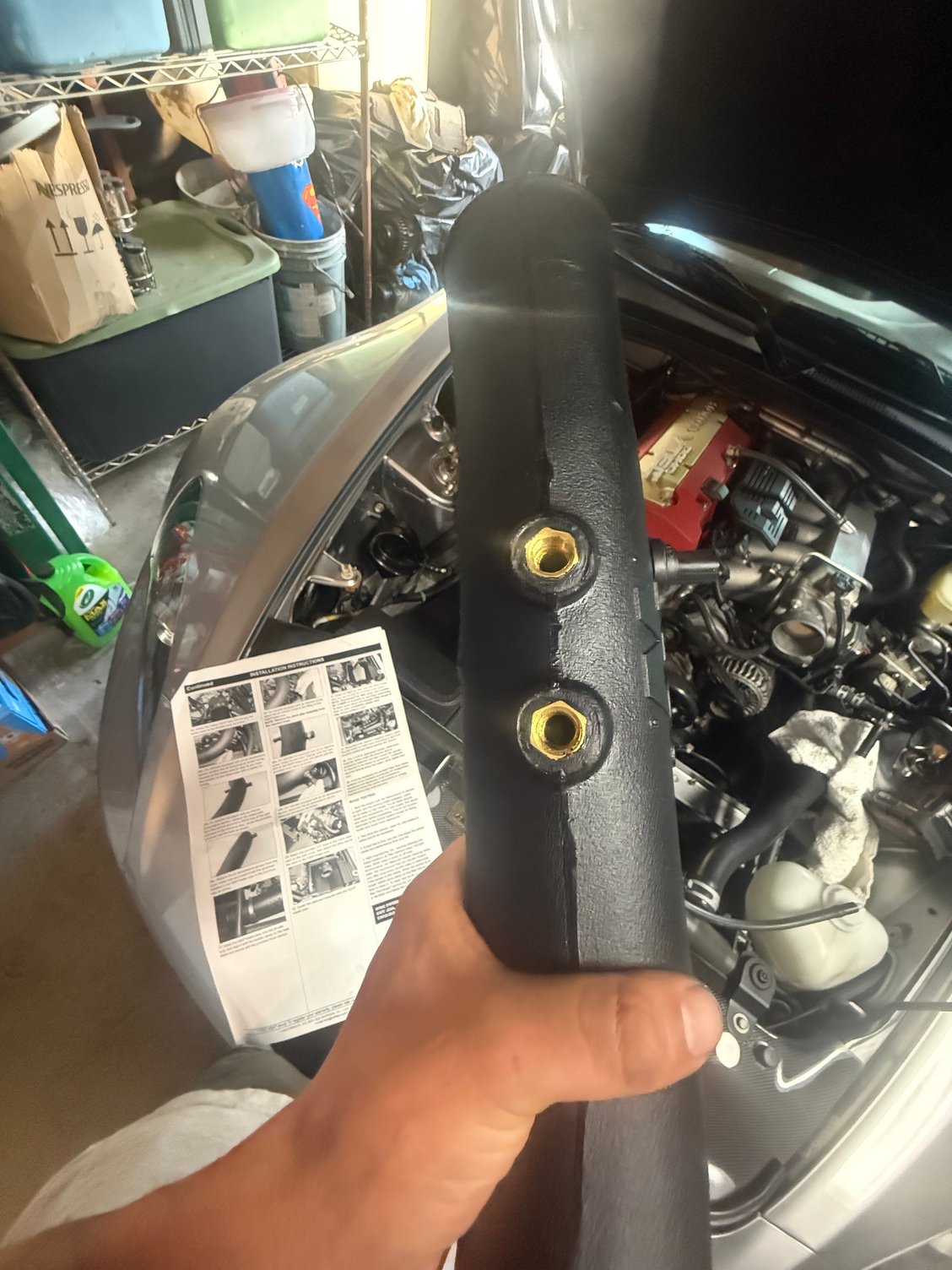

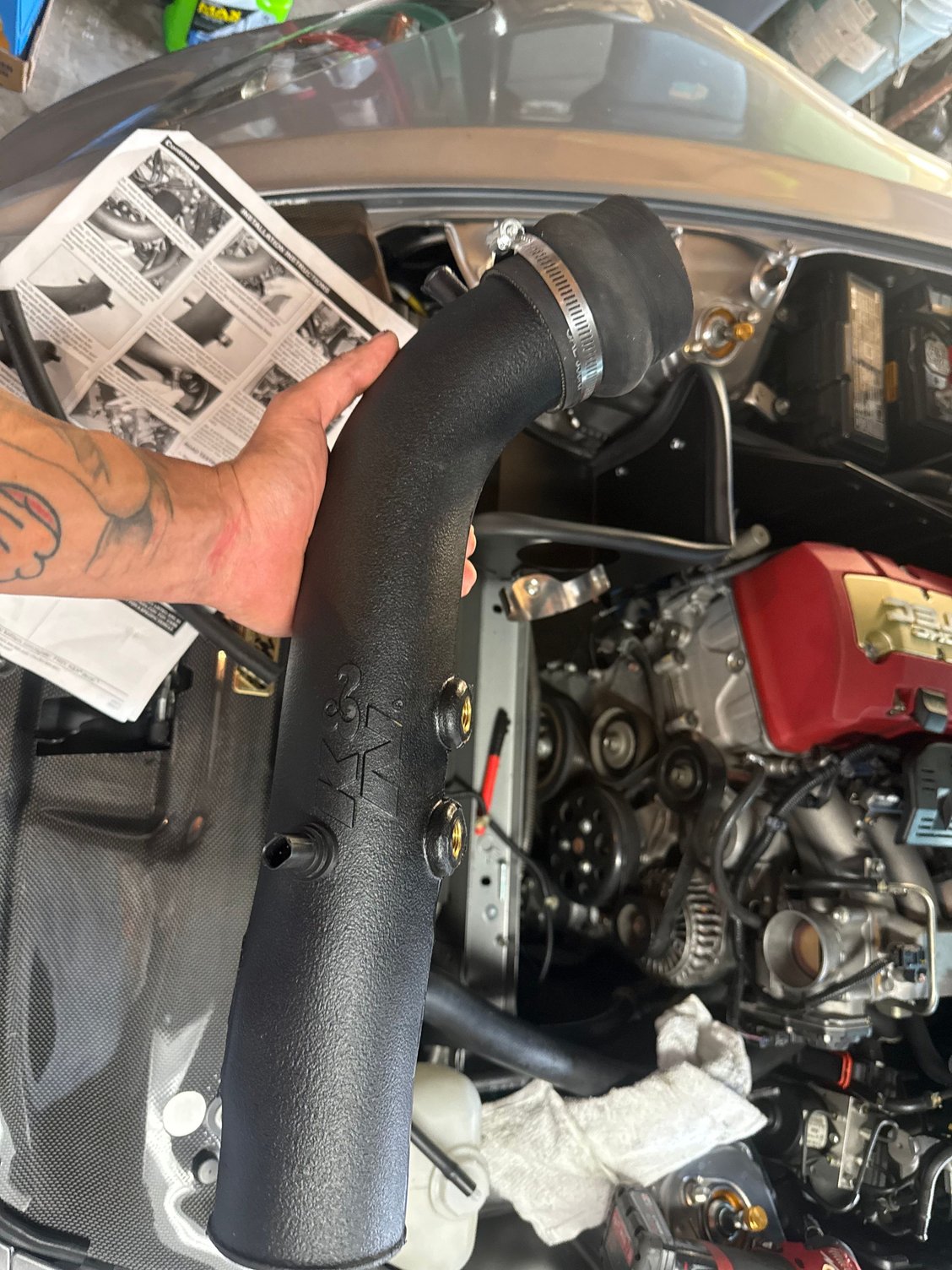

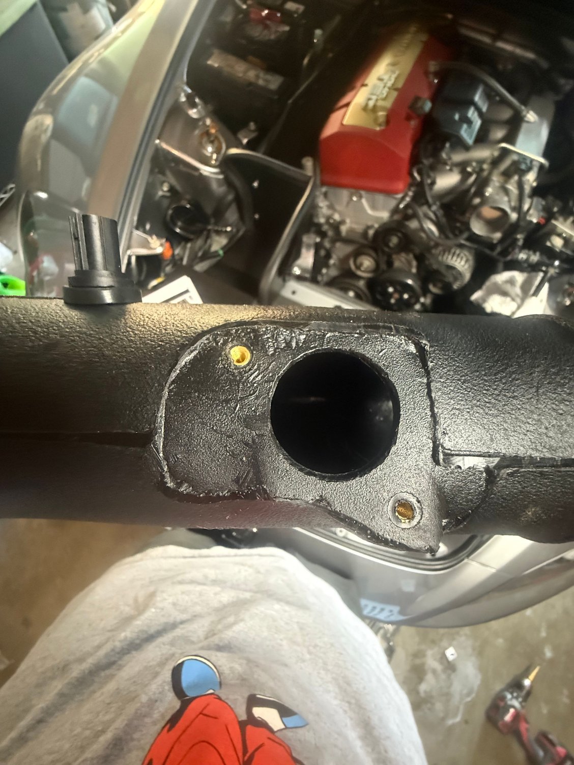

Doesn't seem to fit well, but more importantly crank case breather tube is only on opposite side, has 2 bungs and a big hole near the end of it. Thanks guys. Also didn’t come with any sort of plugs for the bungs and the hole near where the air filter should go.

You received the wrong part

yeah the MAF port is a dead giveaway.

Wrong part fer sure.
I've had this intake for ten (10) years and would not do it again. Makes pleasing intake noises and impresses guys who don't know better -- like me when I bought it! -- when I pop the hood. The free LHT air box mod does everything at least as good but no one will ever know unless you tell them.
1..Remove this.
2. Return to seller -- wrong part.
3. Do the LHT mod,
4. Put everything back to OEM-look.

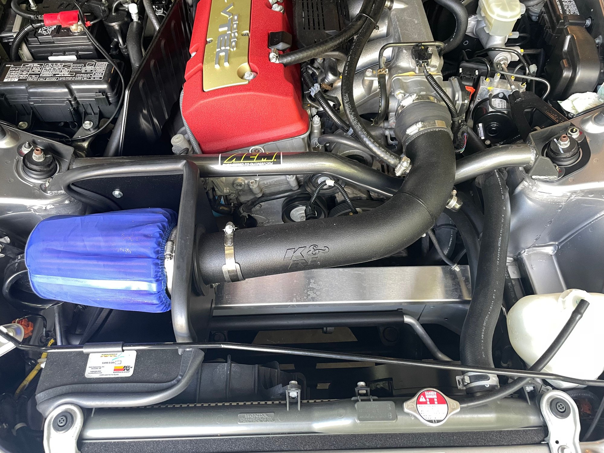

But here's how it should look if you want this cosmetic change:
