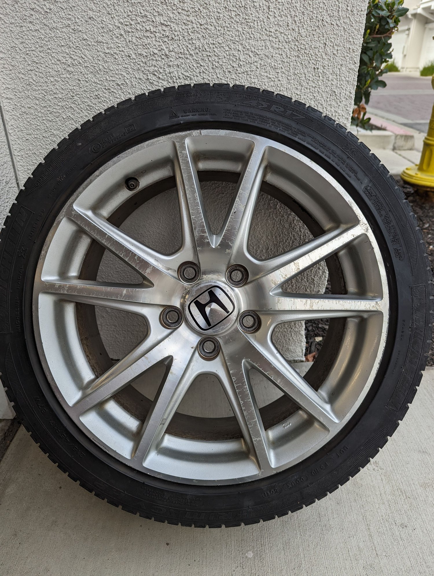

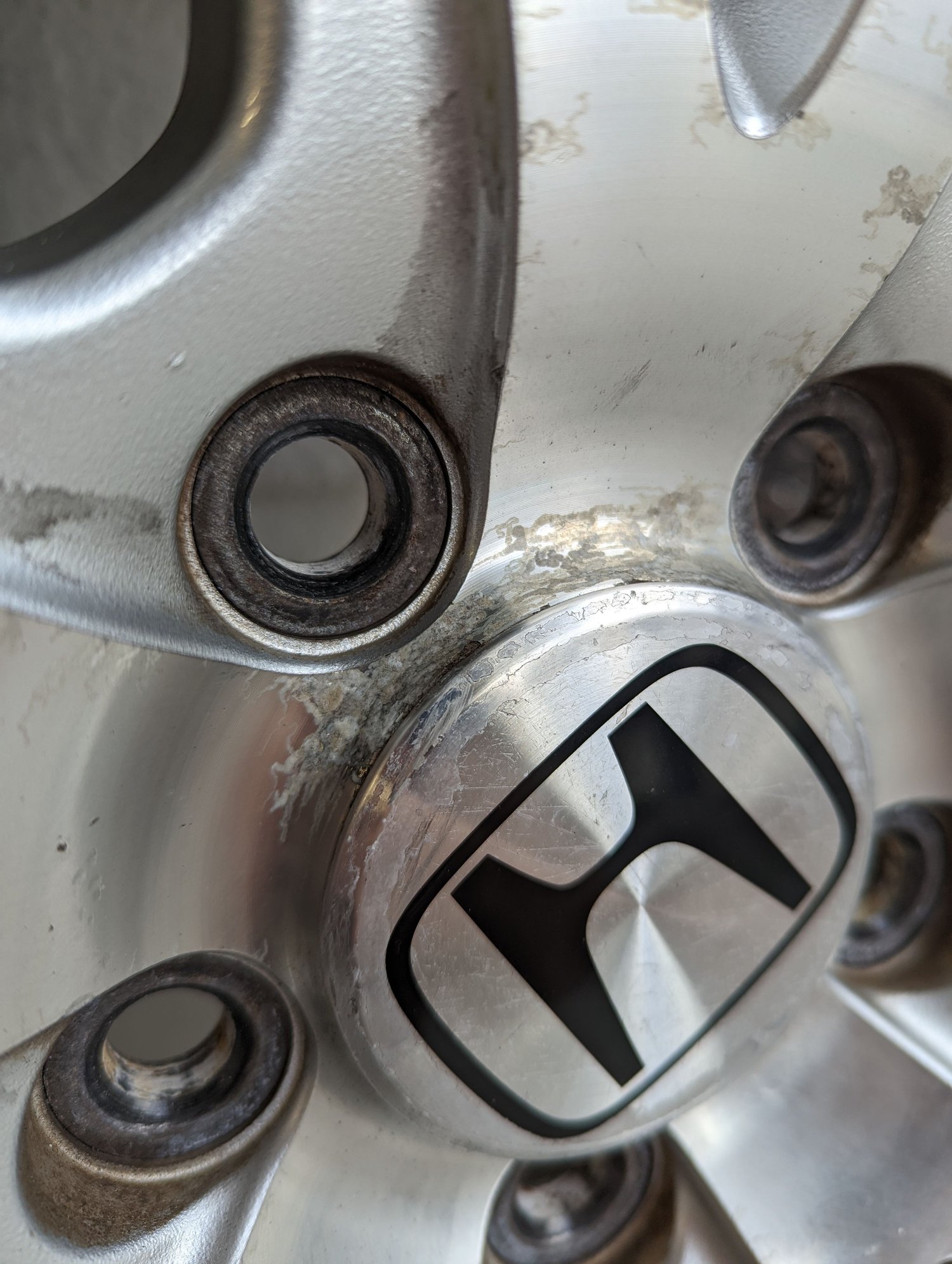

I just picked up this set locally and figured it was clear coat failure. Fortunately(or unfortunately) the places where it's failing isn't the painted surface.
I tried polishing the clear coat and it got rid of all the oxidation. However, it looks like there's still some etching on the surface. I'm afraid that if I hit this with a more abrasive pad, I'll ruin the metal surface underneath.
Any thoughts?

That looks a little further gone than just a polishing pad is going to fix. I’d probably take them to a wheel repair place and see what they say. Likely need a full strip and refinish.

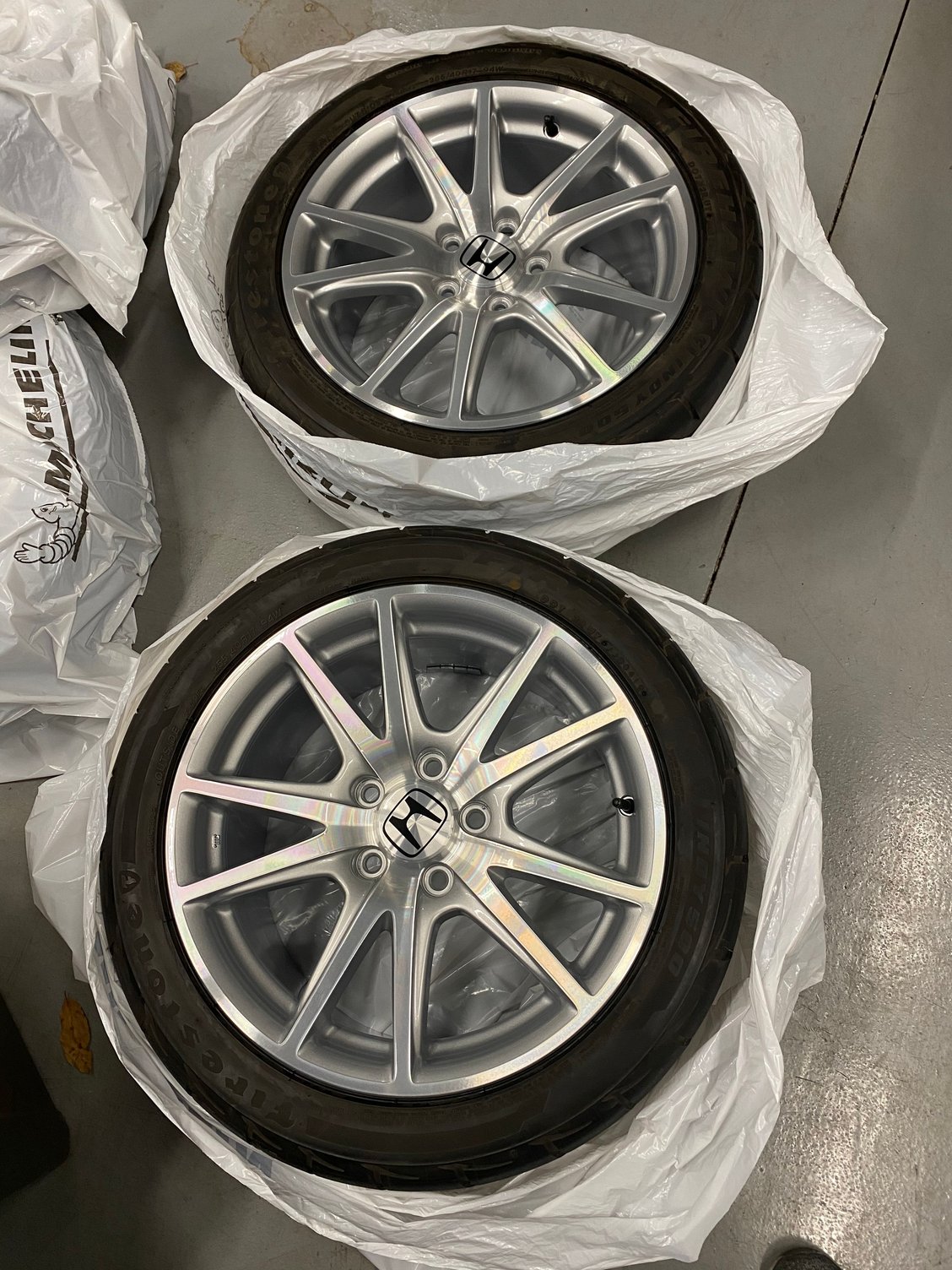

Here are mine freshly refinished. They diamond cut the face repaint the rest and clear coat all.

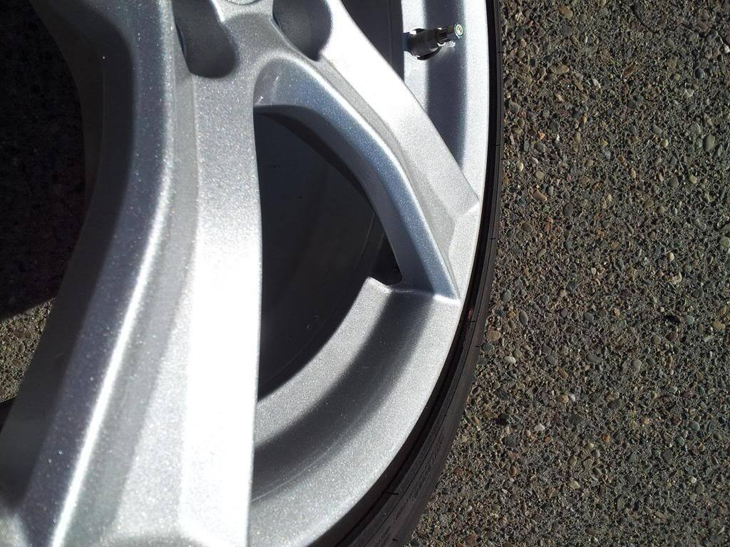

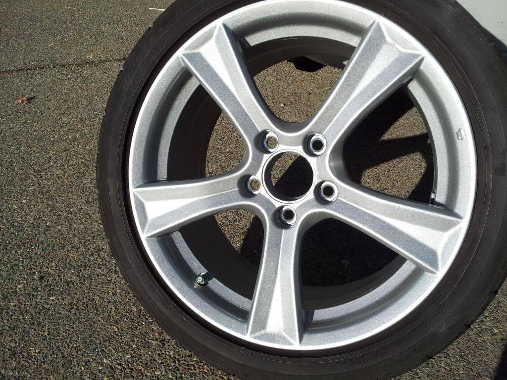

I wound up refinishing my wheels as the PO applied a bit of yellow to match the paint job. Terrible. I did not want to powder coat. I used Duplicolor, twice actually. I did the second one after a year or so. There is a learning curve. Apply at least 5 clear coats. I sanded down enough to remove high spots and roughen the surface for paint adhesion.

The OP's clearcoat has failed. Just needs to be stripped and re-coated.
They should be able to strip all the coating, clean up the faces (leave about 1500 grit marks on them) and re-spray.
You can DIY. But I don't know where you can get methyl cyanocrilate (sp) paint stripper anymore. You'll need 2K clear which you can now find in a can. And a respirator.
And a lot of time and effort.

The set was approx $1000 cdn. Straightened one wheel, full refinish, and ceramic coated.
