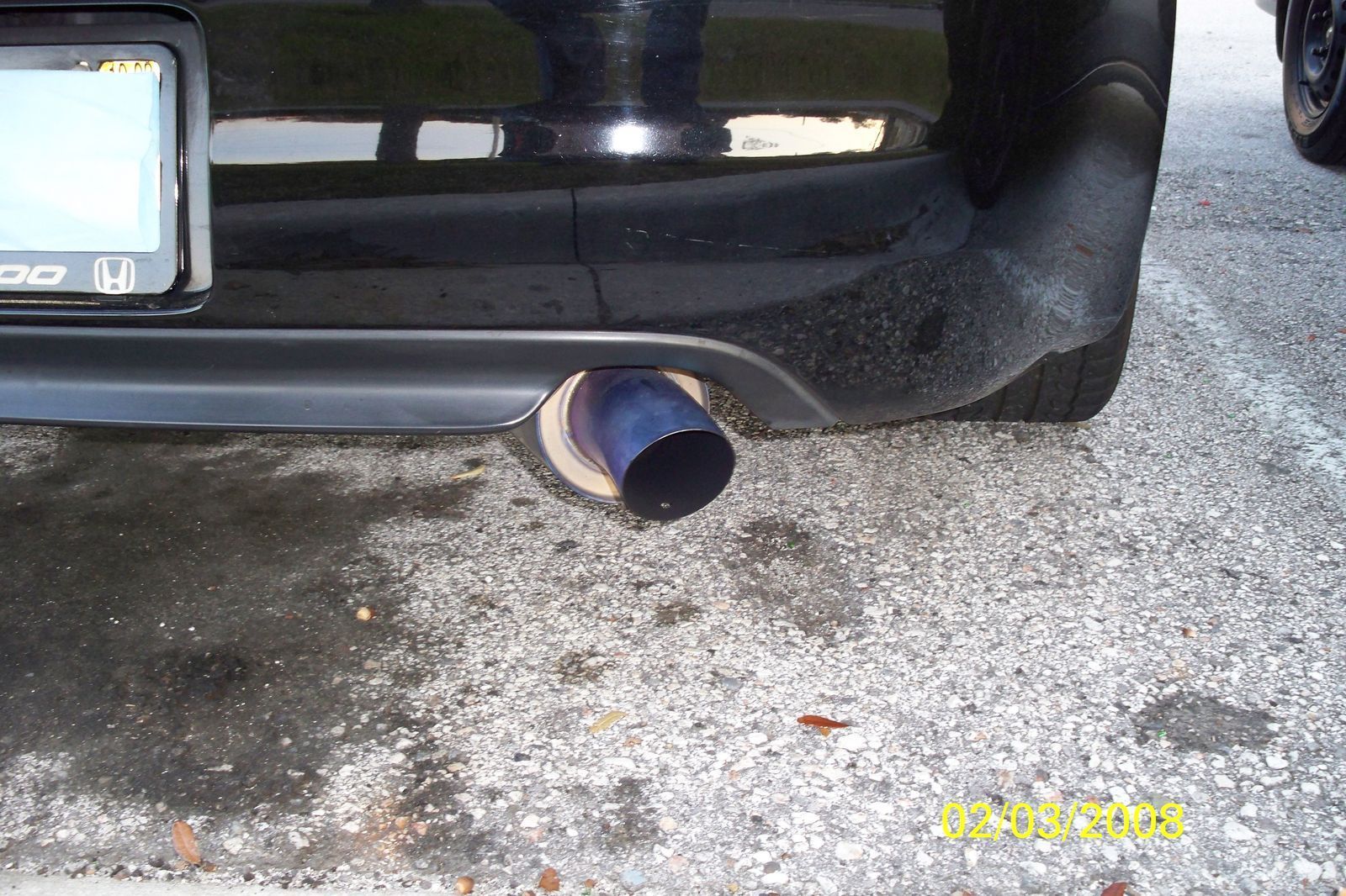

you mean your looking for one of these?
Not me in pic, my friend)
Sorry not for sale lol

^Tease ...
