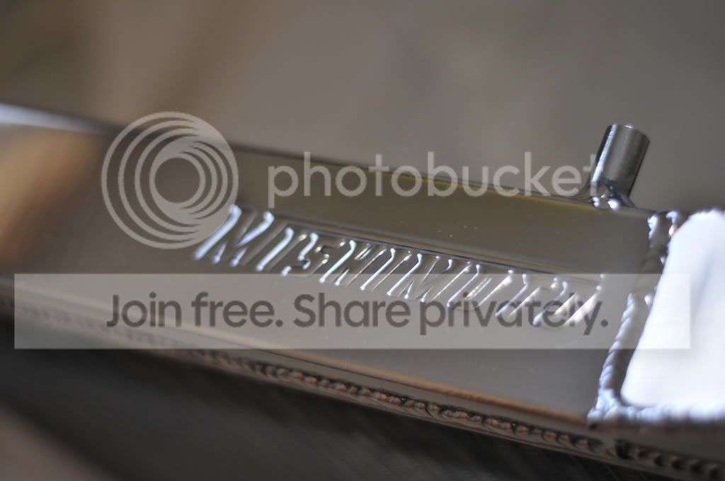

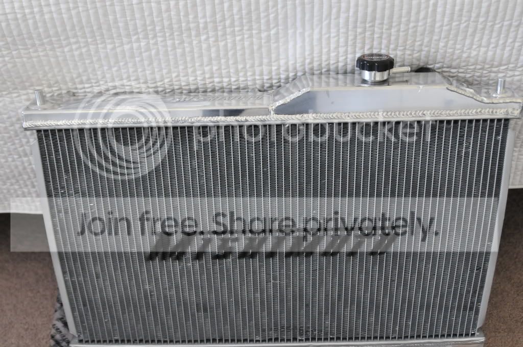

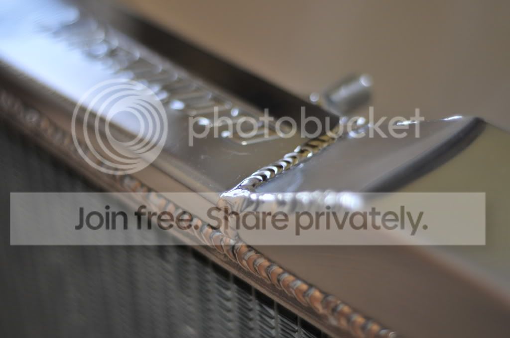

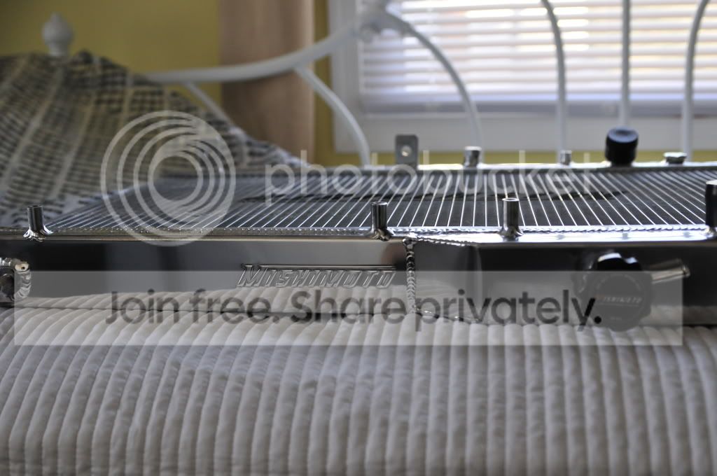

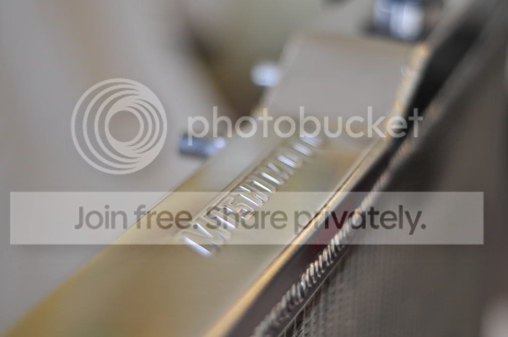

I got this rad for $250.00 Shipped. I don't need the extra cooling, however I like the Bling Bling of an aftermarket raditor.
The welds look decent, however the CAP looks & feels like garbage. I will be using the J's cap as a number of the Koyo caps have failed.
Anyway the fitment is supposed to bolt right on (installing this in a few months), as for the build and welds
