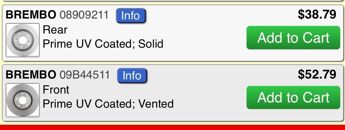

Replacing the brakes on my AP2. Car isn’t tracked but I do AutoX it a few times a year. I’m looking for OEM equivalent rotors. I checked Rock Auto and found Brembos “Prime UV Coated”. Fronts are listed as vented and rears are solid (pic attached). Are these the same as OEM? How do they compare to Centrics?
Also, I plan to use OEM pads, assuming they are sufficient?

OEM rotors look to be about double in price from the Brembos I posted… so just needing some feedback. I don’t mind spending the extra on OEM rotors if they are better.

Any decent blanks are fine. Centric was great but is going away unfortunately, but I have used plenty of NAPA premium blanks in the past for even track use. For autox they are more than sufficient. There is literally nothing magic or special about OEM rotors for this or just about any car. Unless you are buying hot garbage brand rotors, they will perform just the same.I have not run a set of OEM rotors in the 12 years I have owned this car. Street driving, countless autocross events and none on OEM rotors. Same with track use, I always run Centrics or NAPA. I would never pay the honda premium for rotors. Those brembo will be fine. I know I have run some Brembos when I found them on sale in the past.

Appreciate the info. The front rotors are vented and the rears are not, correct? Also, what exactly does “prime uv coated” mean?
As far as pads, yea I really don’t want to deal with more dust and bite has always felt fine, so sticking with OEM’s seem like a good bet.
Any other hardware that will be needed? Thanks

I am not sure what the prime uv coating is. I assume it is the coating on the hub portion of the rotor? Anything on the rest of the rotor gets cleaned off before installing. Yep, the rears on our car are not vented. Really not optimal for the track but no issue otherwise.
I would make sure you have brake clean of course to clean off the new rotors before you install (to remove the corrosion resistant coating they put on there). Some good brake grease for the slider pins. Pads should come with everything else you need. If you have not had the rotors off in a long time or ever (if the car is newer to you) I recommend an impact screwdriver. You can get a good one cheap on Amazon. I have a craftsman one. That will knock out the rotor screws that many times get stuck and cause people headaches. Good to have in the toolbox anyways. And the one I linked has the larger screw bits that fit those screws better so less chance to ruin the screws. I put a touch of antisieze back on those anytime I remove them from any car.
