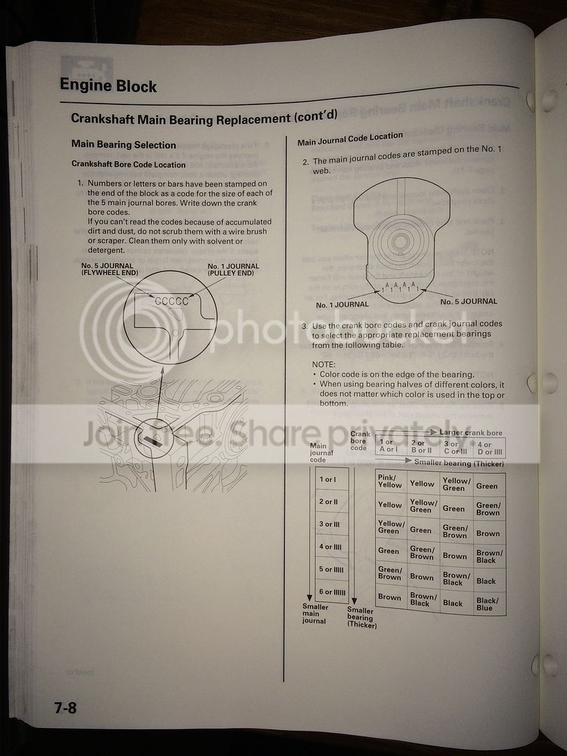

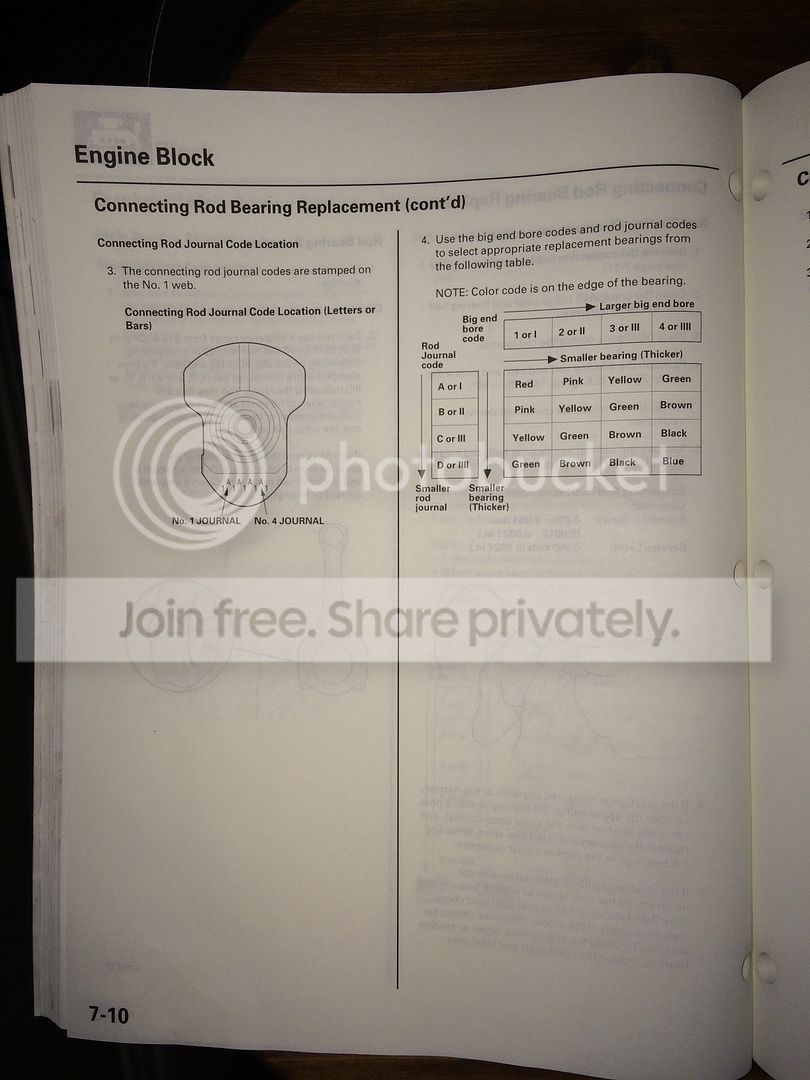

You need the size of both the crank pins and the rod ends, then there is a lookup table in the factory service manual to determine what "color" bearing you need (color is how they discern thickness). CCCCC isn't the rod pins though, it is the main bearings (there aren't 5 rods, after all).

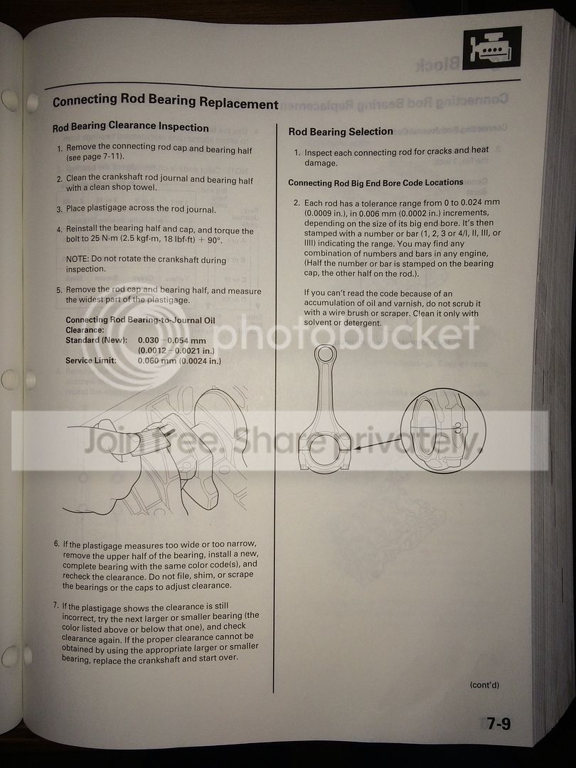

Also, if any work was done to the crank (i.e. spun bearing & the pin was sanded & polished afterward) then the measurement mark on the crank is no longer relevant, and you will need to plastigauge to be sure you have the correct bearing thickness.
It is also good practice to plastigauge all of them anyway, to be certain the clearance is correct.

Sorry, my fault. I added an extra "C". And yes the crank was polished.
Would you happen to have access to the chart that's online base? Car is at the shop and that's where my book is at. (2006 ap2. Google providing all kinds charts that aren't relevant)

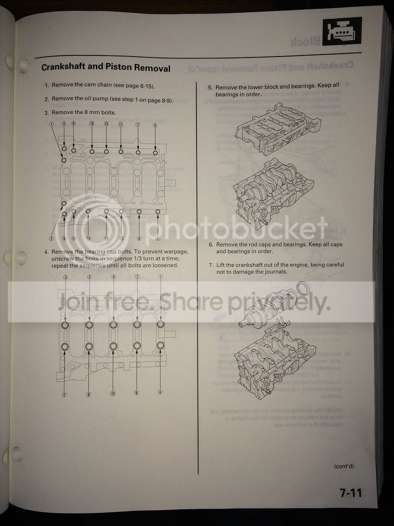

Let me dig out my manual and take a look, standby...
here's my manual... the manual is titled '2000-2002 Service manual' FYI
