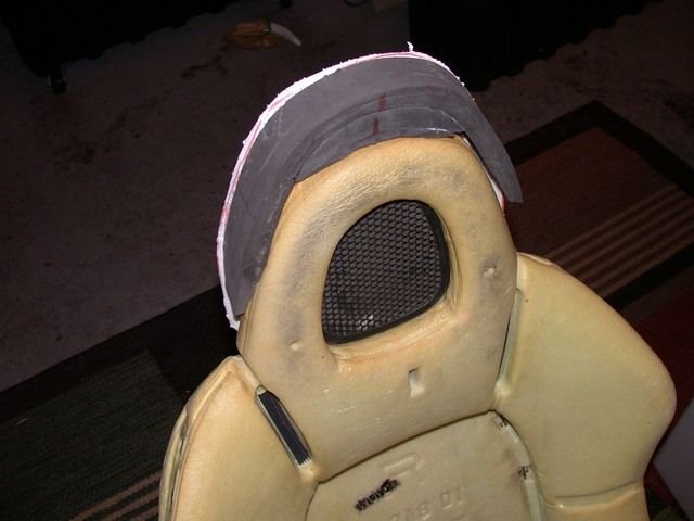

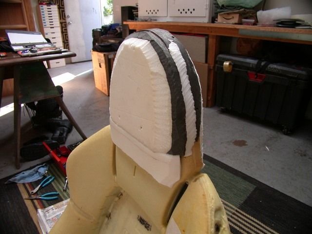

I did a ap1 to ap2 seat upgrade...
I kept the frame and padding -- just added more closed cell faom to fit the AP2 seat skins.
building up the height
enclosing the head rest and craving to fit...
one done...
both done and installed!!
I really like the full headrest
