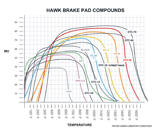

Stoptech street performance pads are absolutely the cheapest piece of crap you can buy. I have the pads for in between track days driving around on the street. I bought them because they are cheap but I fully intend to never drive them to their limit since I can already feel their initial bite is crap and their maximum effort is weak. unfortunately stop tech doesn't have a mU vs temp graph to confirm this or have any documentation as to the performance of the pad, but just because it comes on a $2000 set of bbks, does not make it any good.
Go find the fast track guys and look what they are running on their cars - most of them are running Blank Rotors + Race Pads + braided lines + fluid. Some, myself included are running brake ducts. Running BBKs is a nice to have, if balanced correctly, they reduce unsprung weight and supposedly in the long long long run, they may eventually be cheaper in terms of pad life. In terms of sheer performance, they aren't going to stop you any better than the stock braking system.
an example of a mU vs temp graph:
this is not as useful as you cannot see the relation between mU and temp:
