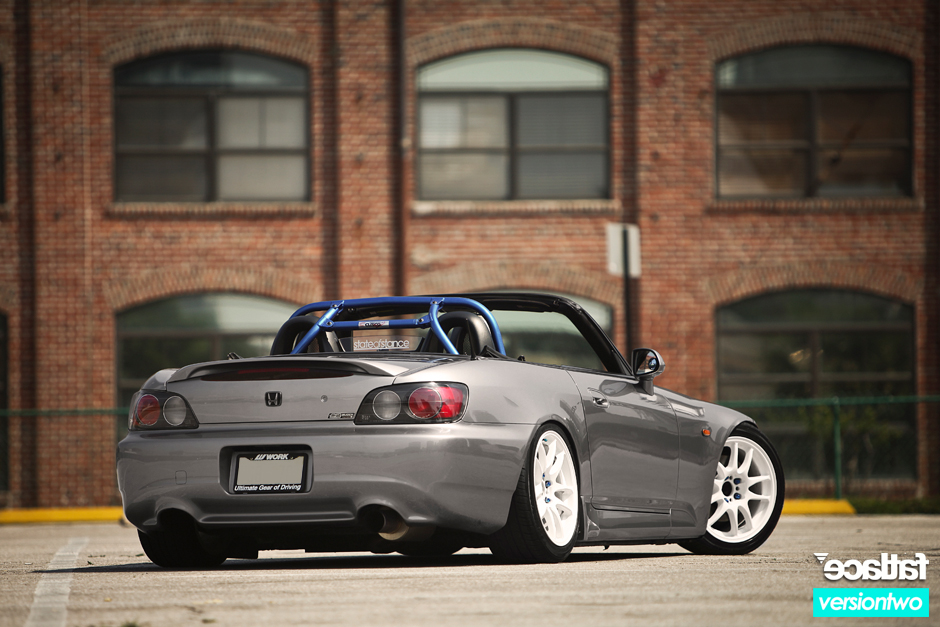

Hey everyone, im looking to get a Roll cage but i want one where which has going from that back to the front of the car running parallel to the door, and i dont mean the one over the head.
Im NOT looking to get the two bars running from front to end over your head,
I AM looking for a door roll bar like this
paired with this

that door bar you pictured requires the cutting of the inner door skin, the door bar protrudes out, you will loose the use of your window, you will need to remove it or have it always up, that owner cut up his door panel and put it back on for looks
also that door bar is goin to require cage work up front, a front cross bar under the dash, a vertical bar by the front a pillar for it to connect to
your stock doors have door bars in them, and with a aftermarket door bar like you pictured will require you to remove the stock door bars
