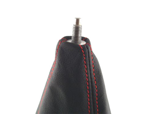

Has anyone ever used a shift boot adapter or "collar" before? I'm not too thrilled about the way the stock shift boot sags down...

Pop your console up and with the shift knob still on pull upwards until the boot looks like it's try to squeeze it's way over the shift knob then take a ziptie and put it around the shifter right below the knob and make sure it's tight. Pop everything back into place and problem solved. It won't move either. I've had mine like that for months without it ever coming loose. I also always hated the way the boot just sagged.

I just lifted off the center console and put a small rubber grommet on the top of the threaded portion. The boot rests on that and then the knob screws on. Price....free.

I used a garden hose washer on the back side of the boot - just cost a few pennies and the boot doesn't move unless I move it.

i actually tried my friend's shift boot adapter tonight. it does a great job of preventing the oem boot from sagging down... i will need a zip tie or an o-ring securing it from underneath to keep it from moving up though. i even had room to put the oem locknut on top of the collar.
i know i'm being picky but i'd like a small gap between the bottom of the knob and the top of the boot. this way, i can pretty much hold/shift the spherical knob from different angles, etc. without the boot getting in the way.
