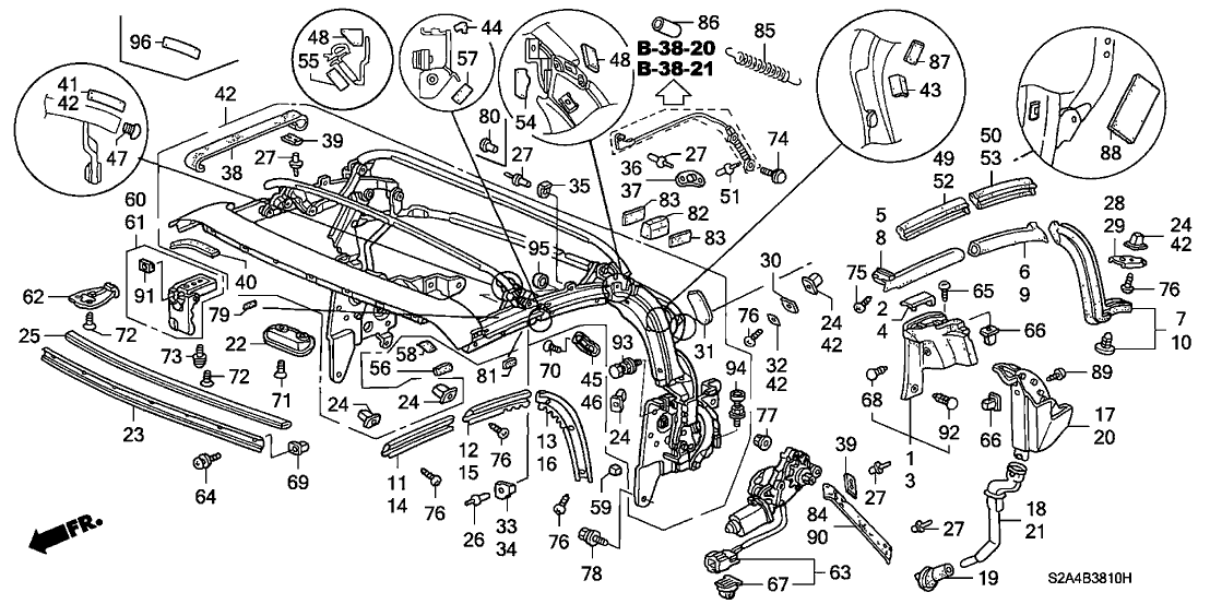

Hi guys,
Anyone who knows the part number of soft top frame rivet?
I am going to install a modifry strap, but first frame has no rivet like below.

Looks like the same commercial pop rivet (#27 in the diagram) used many places. @2poor2mod will probably know the exact size since he installs scores of roofs.
-- Chuck
Thank you. Chuck.
But some guys answered #39 is the part that I am looking for on the other forum.
I need to confirm check again.

Thought you wanted the rivets.
#39 is the plate (secured by the two rivets) shown in the photo you posted and isn't used for the Modifry strap which is not clamped under it, just has little metal tabs that stick in the holes on the top of the rivets. Holes in the frame may be enough. Designed to simply cut off the worn straps and clip the new strap onto the bars. Easy peasy.
-- Chuck
Now I understand your point.
Thank you so much!

as Chuck mentioned, no rivets needed to install the modifry straps, they simply install into the back of the pre-existing rivets.
