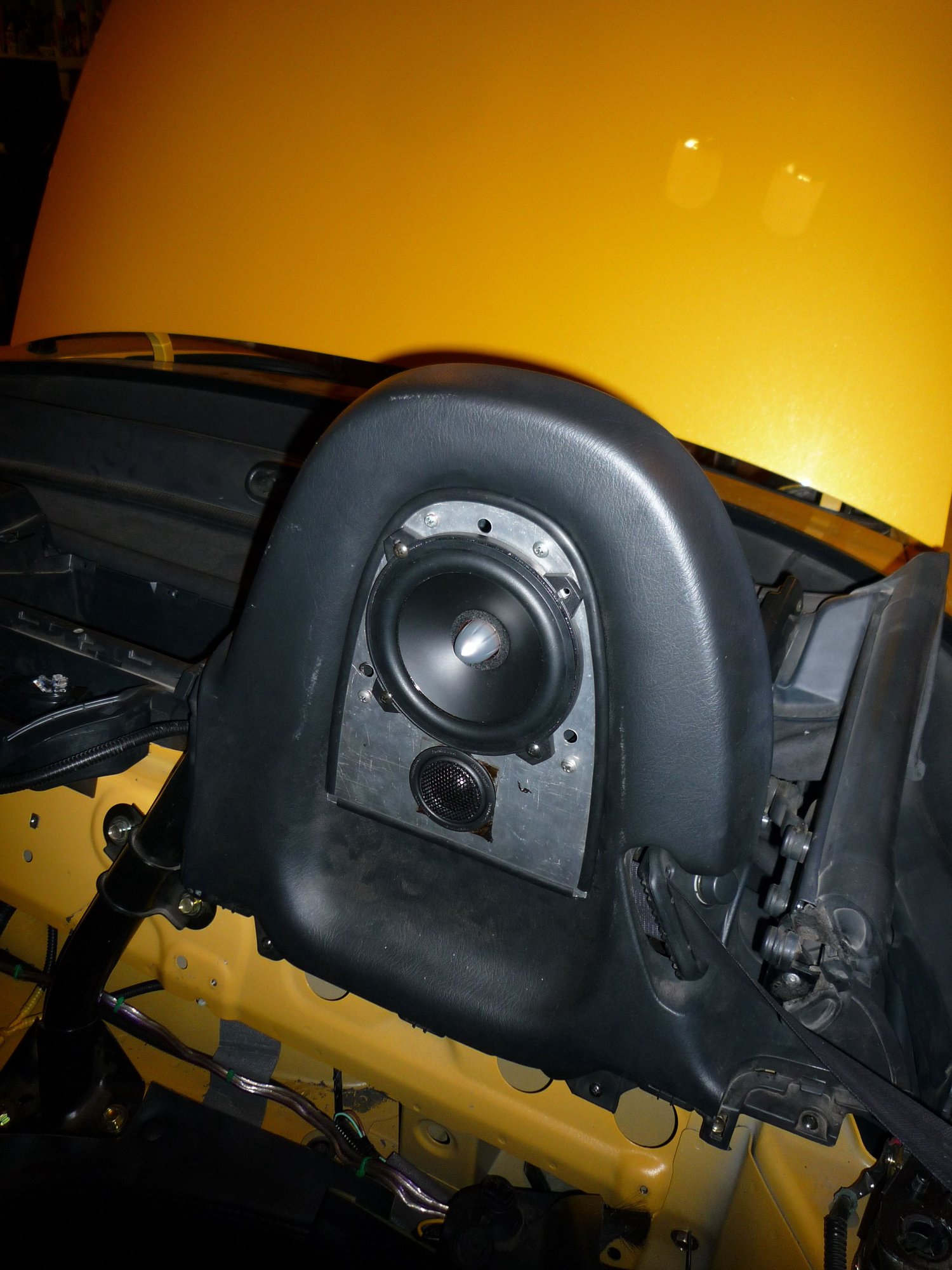

Current Setup:
Stinger Elev8 with digital out in the factory location
Modifry DCI

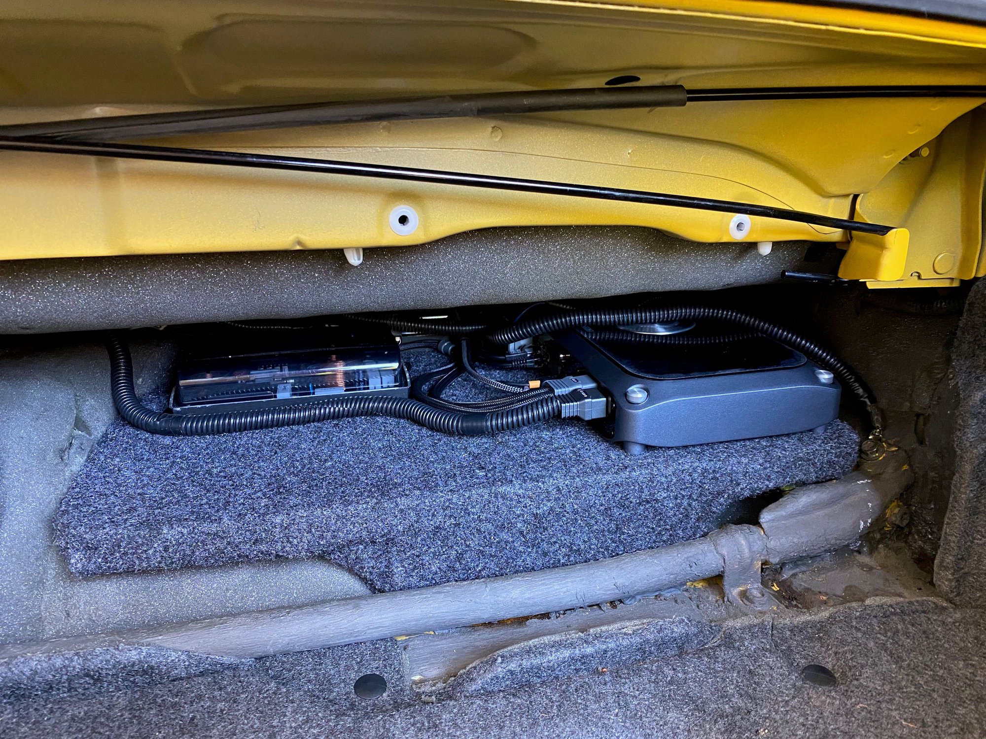

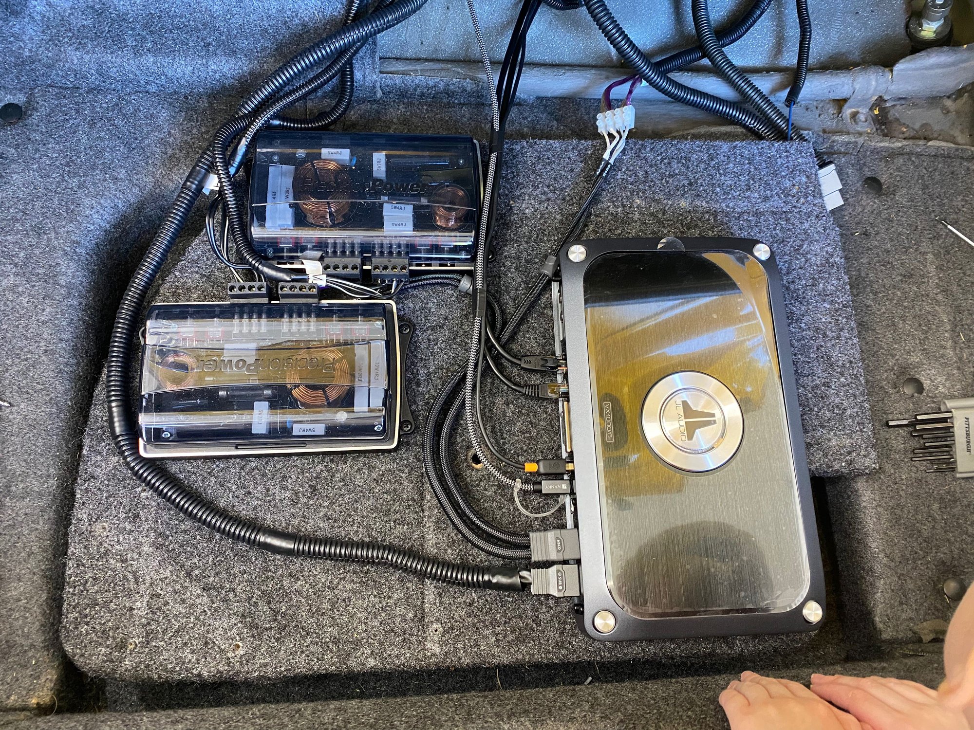

JL Audio VX1000/5i in the spare tire well
JL Audio DRC-205 in the center console for bass control and overall volume/program control
JL Audio Stealthbox in the rear trunk cavity
PPI 365CS front speakers (old A/D/S rebranded as PPI)
PPI 355CS rear speakers (old A/D/S rebranded as PPI) in S-Pods

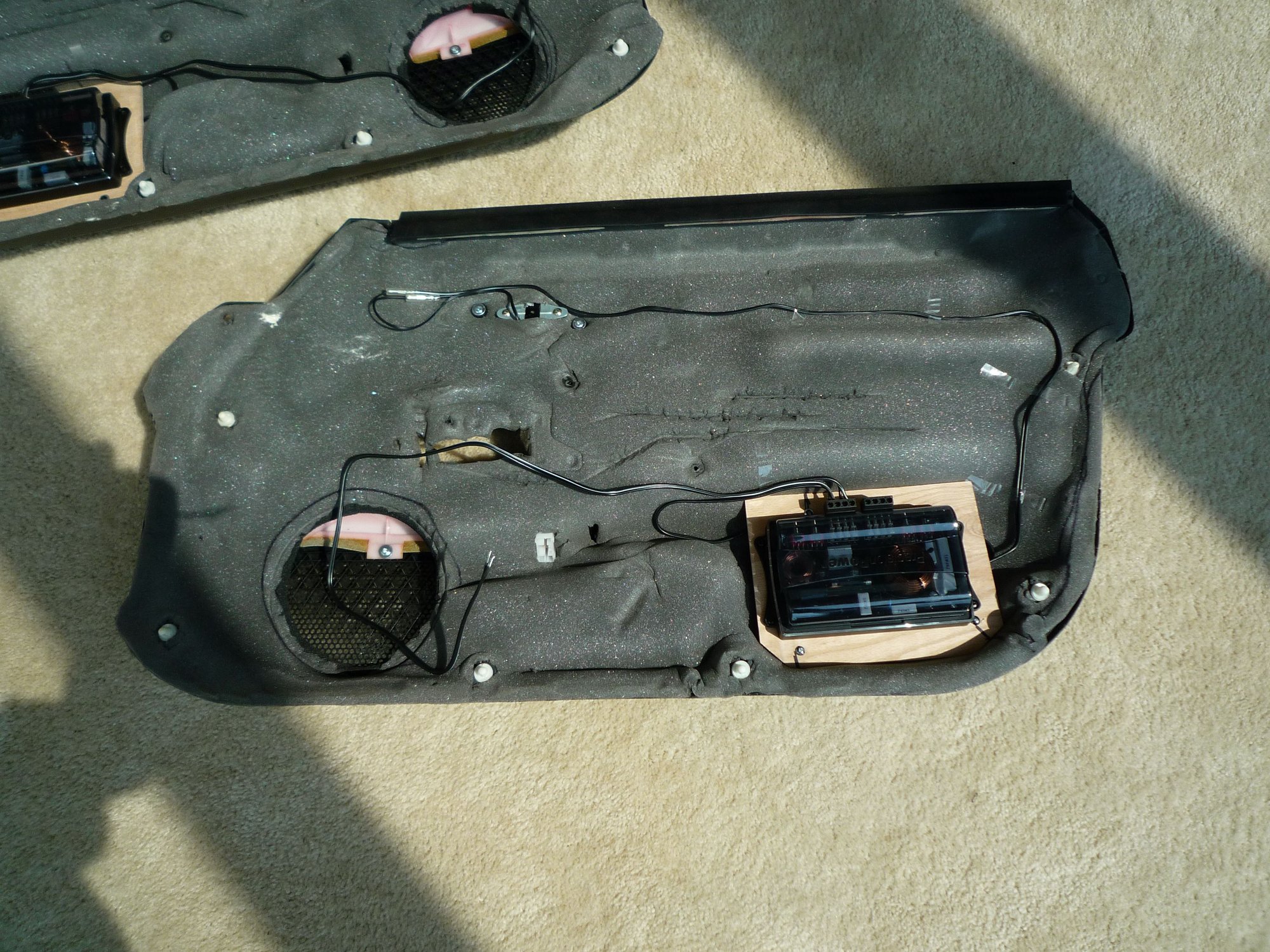

Entire car sound deadened
The VXi amp takes the L+R signals, mixes them, reduces them by 15-20 dB, delays them, and then sends them to the rear speakers. This helps provide much needed fill/volume, but doesn't smear the stage.
