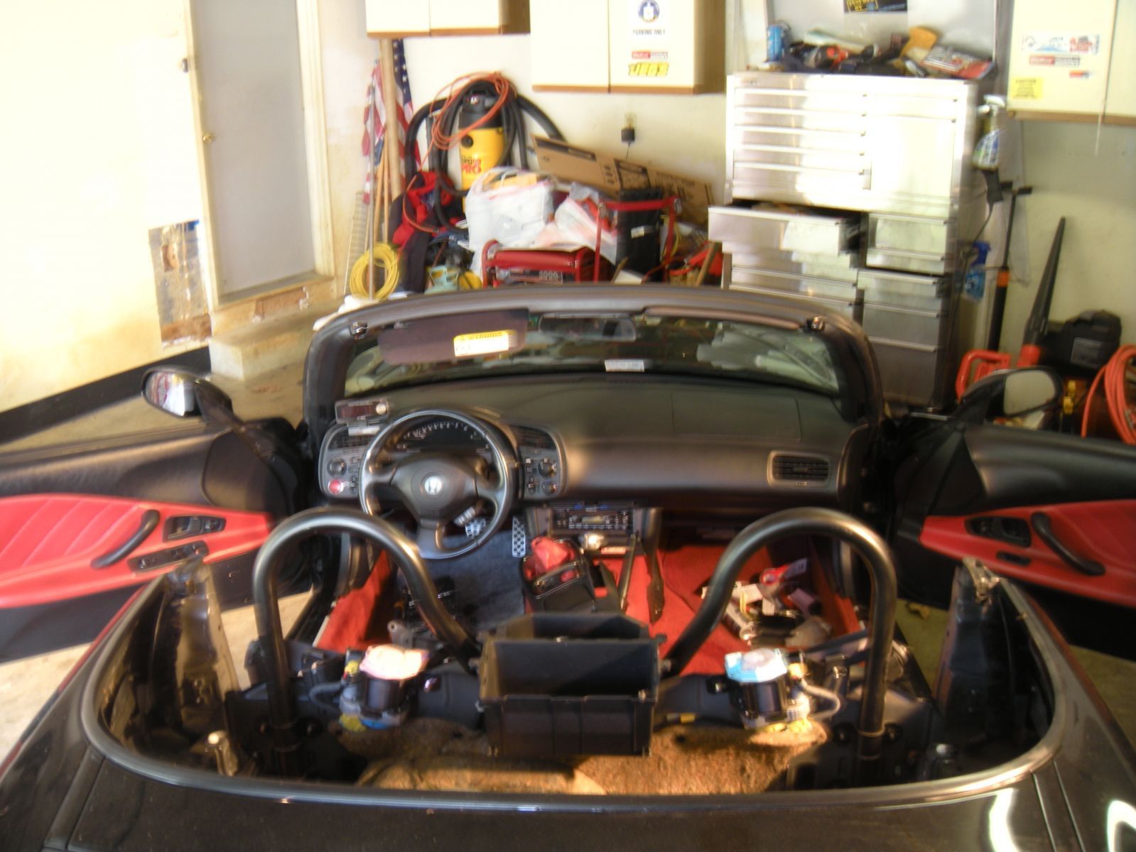

Since my softtop was junk I decided to take it and most of the interior out

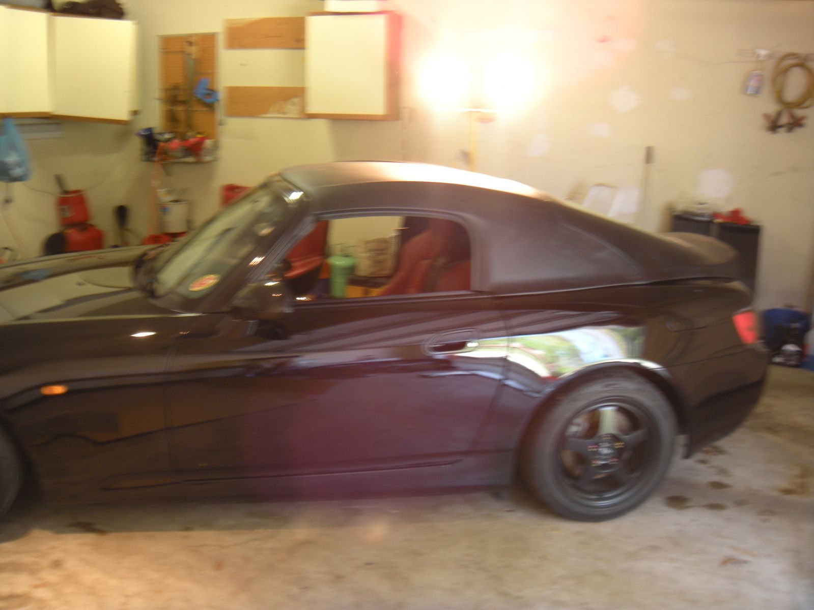

Test Fit..
Fitment was great! i give it 9/10 now time to weather strip and fasten it down.

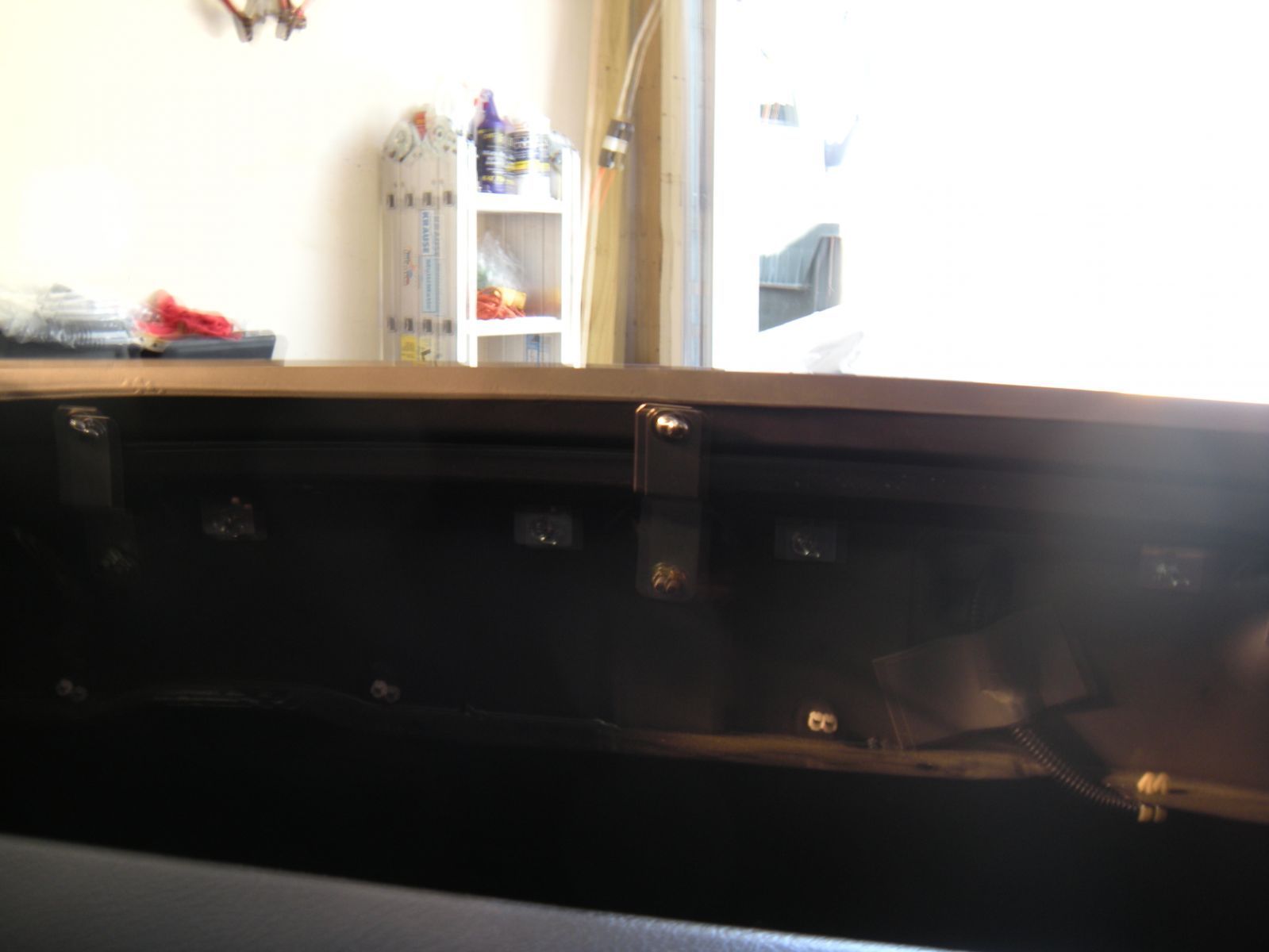

In this pic it shows where I put the weatherstrip on the underside of the main section. it will sandwich in there when its tightened down. This also helps with wind noise. Use weatherstrip adhesive to hold it in place otherwise the pressure from the top will push it out of place. Which you can see mine is starting to do.
Not long after installation I found that the supplied foam weatherstripping is junk. I used rubber weatherstrip from home depot.
I put one long peice on the bottom of the main section all the way around where is contacts the boby(this will stop creaking). same on th back of the main section where the rear section sits on it. and the two supplied window weather stripping.

3 of the 5 brackets that mount the main section
The 2 sides, 1 behind each window. I've noticed there are a few variations to how this one mounts. On mine, the bottom of the bracket clips into a pink clip which I believe is the bottom on a trim peice.
And the finished product...before paint..thats next week.
