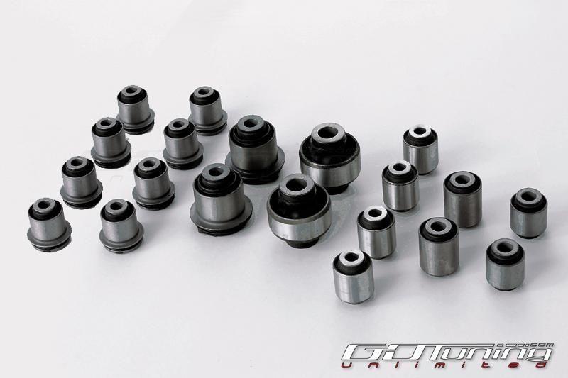

Hey guys, so my car is pretty much at the point where I feel like I should replace all my suspension bushings. My S is a daily driver with 145k and last time I got an alignment, my compliance bushings need to be replaced. At that point I figured it would be a good investment to replace all the other bushings as well. I've been trying to do as much research as possible and wanted to hear other people's experience and knowledge between Spoon and Ballade bushings.
I'm leaning a bit more towards Ballade just because it's a bit more affordable at around $900 or their other kit at $1000, as far as I can tell, the only difference is the cheaper set is machine finished and the more expensive kit has black coating. Spoons kit sits at almost $1200 for their full kit.
My car is mainly a daily driver and go on the occasional spirited canyon drives, but I do want to fully enjoy the car and attend autox and track events, maybe a few times a year.
Spoon:
Ballade:
Any help would be appreciated!
