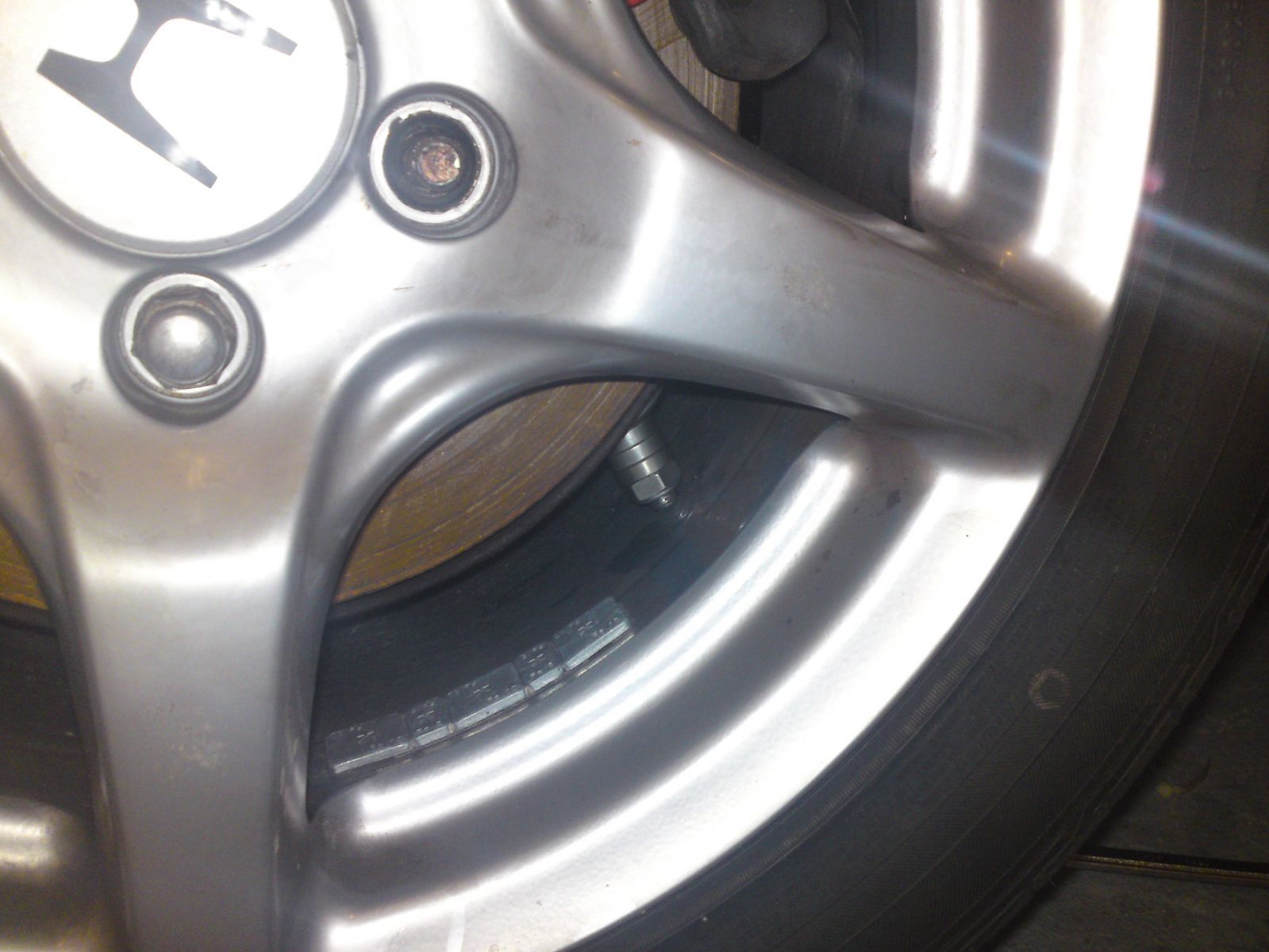

Hi guys
Im finishing up a full suspension over haul.
as you can see ive taken the arms off changed the bushes for powerflex bushes, new geo bolts and installed coilovers.

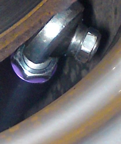

Then the 'rear bump steer kit' arrived. Not exactly what I was expecting, they turned out to be rose jointed race items. Of which i have no experience.
There is a lot of washers, what are these used for?
There is huge ammount of toe available with these items. Should i be using the original geo bolts with this?
Now here is the bad bit, they do not fit inside my wheels!
You see the thread catching slightly on the inside of the wheel.
Have you had experience of this setup and care to help out?

They wont work with stock 16's.

Thats really was not the answer I was looking for !
Turns out they arrived with the washers on the wrong side of the rose joint which threw me a total red herring last night.
So moved the washers over, and hey presto they fit my 'stock 16s'

The washers are to assist in making sure the arm is as level as possible. I currently am using one washer from the bottom like yourself. Also make sure that you been the heim joints properly lubricated over time, thanks to rain and car washes and such
