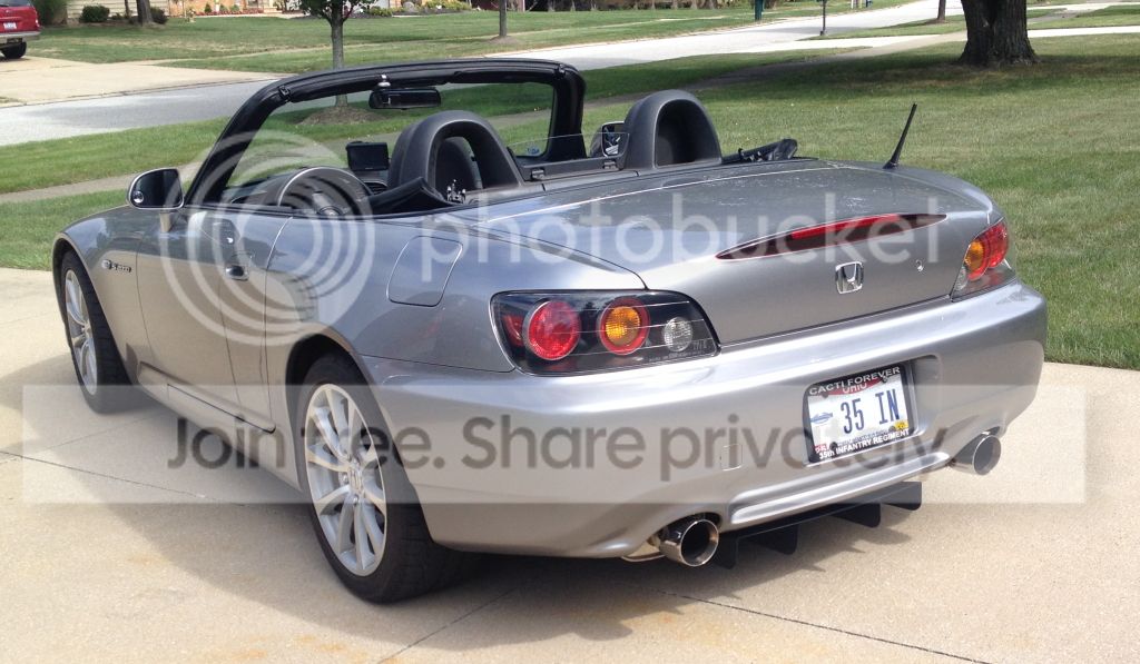

Fit perfectly (and highly recommended) on my 2006. The Speed Academy guys have this exhaust on their track BADASS2000 to meet noise restrictions at some tracks and to allow driving on the street. I call it "mature performance,' they call it "gentlemanly." It's both. No drone; can converse inside the car; aggressive when it hits VTEC. (Since you have an '06 I highly recommend a Gernby Hondata FlashPro tune. VTEC at 3600 rpm with this exhaust provides startling mid-range power.)
Removing the OEM exhaust is the hardest part. Start by removing the hangers at the mufflers and work forward. Rear subframe cross bar has to come off. Watch the Mighty Car Mods episode where they put the Invidia Q300 on their car. Same procedure. I originally installed the Q300 on this car but the horrible done and noise had me ripping it off within a month. The swap took less than an hour since the OEM exhaust was no longer on the car.
Mine is behind a 63.5mm Berk high flow cat -- also highly recommended.
Photos taken to show the Alloy Craft diffuser but show the Medalion Touring nicely.
-- Chuck

Originally Posted by Chuck S
-- Chuck
What lift / stands are those?, those are awesome!
How do you like the diffuser?

Not sure if the diffuser is merely decorative or not. But it doesn't seem to be bothering anything.
