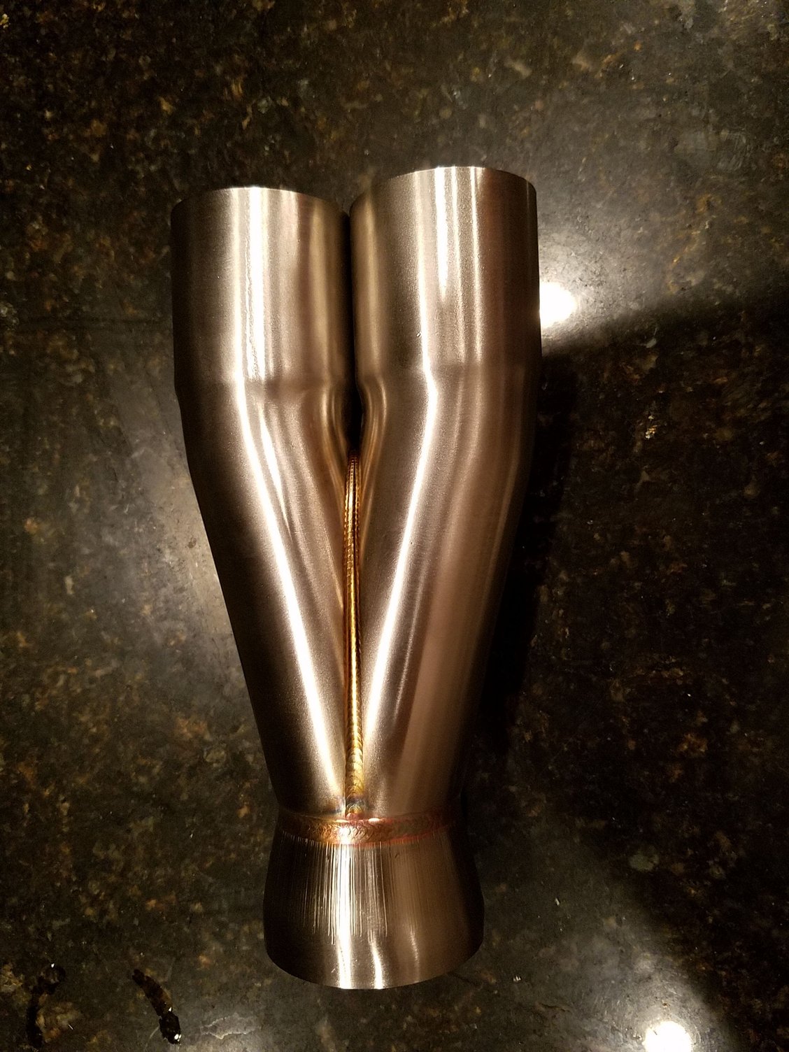

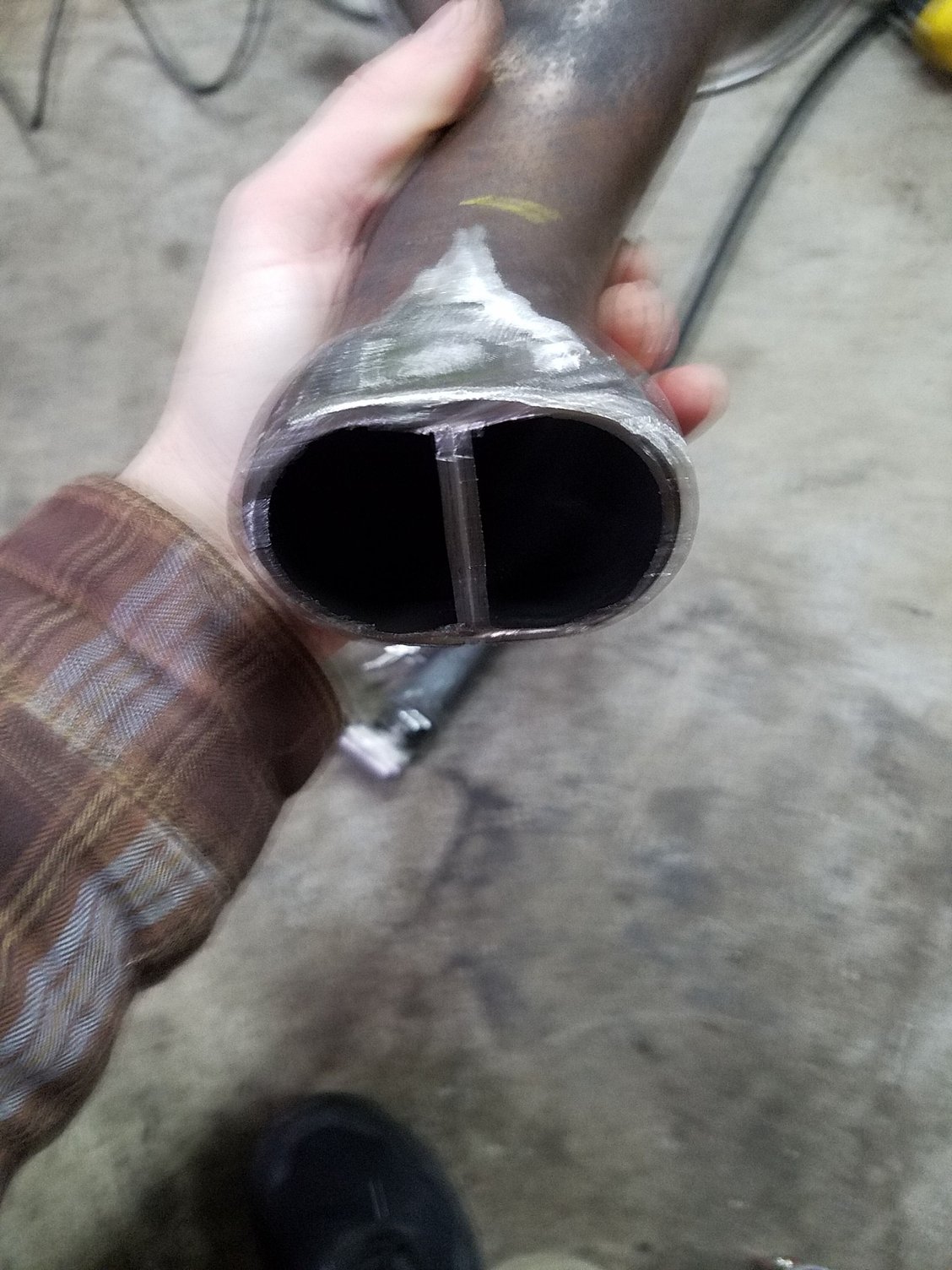

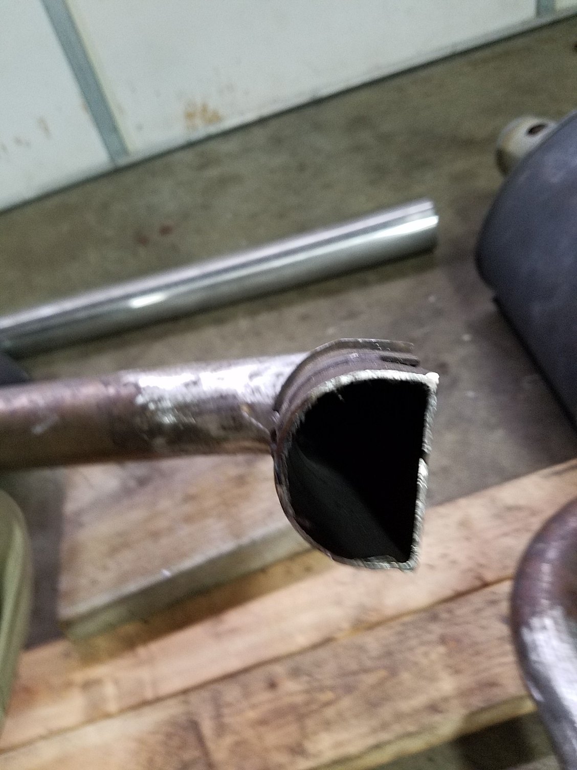

I am currently working on a DIY mod to our exhaust also and will post pic's when done. My approach was a little diff after studying the exhaust I found the most restriction was at the actual 1-2 split. I was amazed after cutting it open at the split they just crimped one side of each tail pipe and butted them together. I cut the crimped section out then add straight pipe back on but couldn't fab the transition to my liking. I was able to find a stainless Merged-Y from Vibrant exhaust for $72 "ouch" and will be adding this for the split so exhaust diameter will stay actual size throughout. This probably won't change the exhaust note at all but flow should be gained. I went this route for now and may do the UK later with a 1" dia. to relieve some pressure with the least amount of decibel change. To be continued with Pic's.

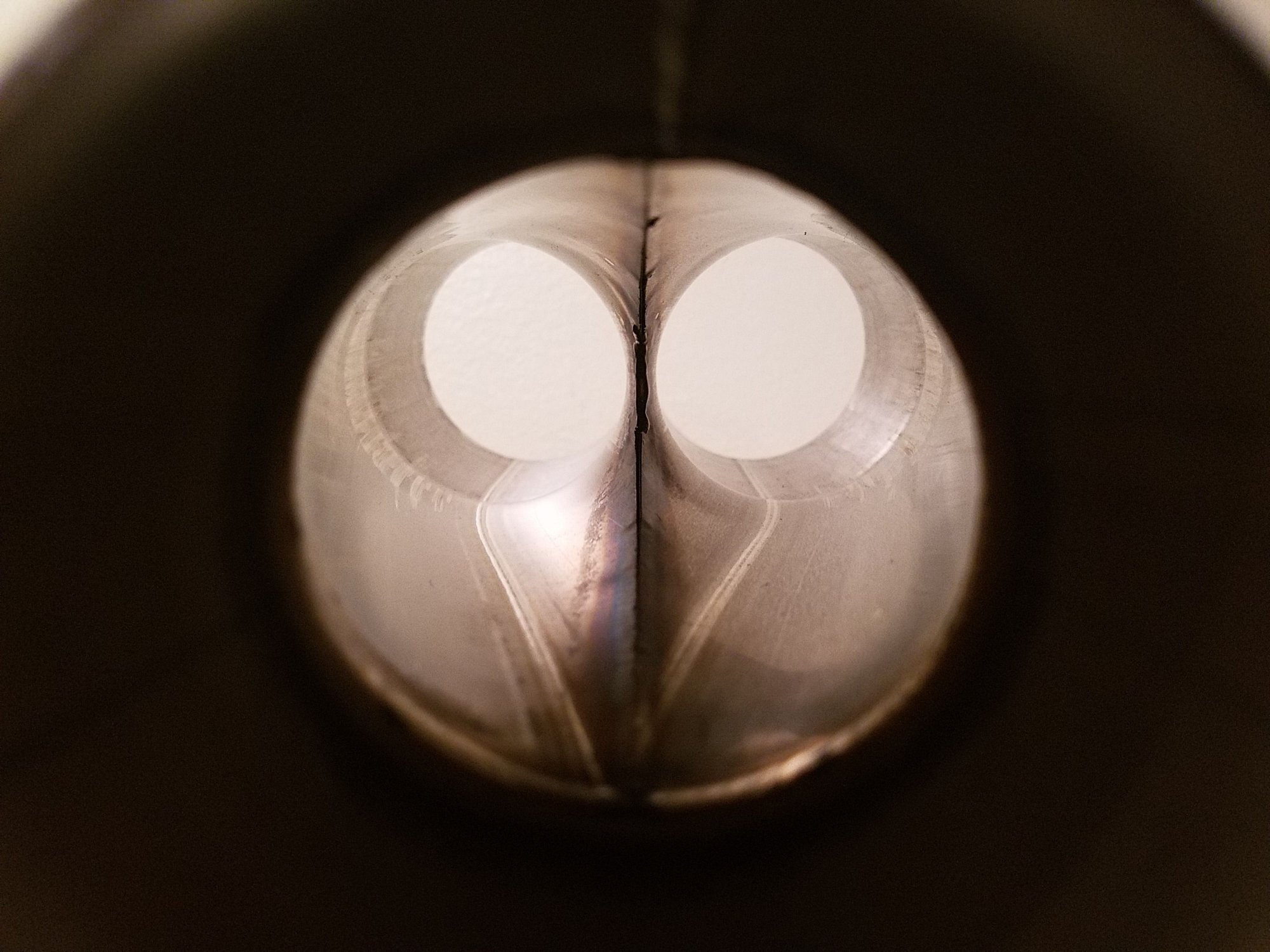

Vibrant Y merge came in last night so
I will do some more test fitting for lengths etc. I must say Vibrant stainless isn't cheap but it's stuff is show car grade. It's beauty factor is overkill but it was the only one I could find with the diameters I needed and the dual splits are tight (width wise) which is close to matching OEM width at that point. Magnaflow makes a stainless Y merge (I used on a Vette exhaust) but they are machine stamped and the dual splits are much further apart.
I will add that this mod is a little above "basic" fab skills and takes some trial and air fitting/cutting. Also the drivers side tail pipe starts it's bend right where you need to cut and requires some hammering to get perfectly round before welding/adding a short straight to go into the Y. I inserted a large socket inside of pipe to get perfectly round ( can't remember size). Another issue was the O.D/I.D of the OEM pipes don't allow for a perfect slip fit and require minimal cleanup on either the outside of one and inside of other or vise versa, a very snug fit even then.

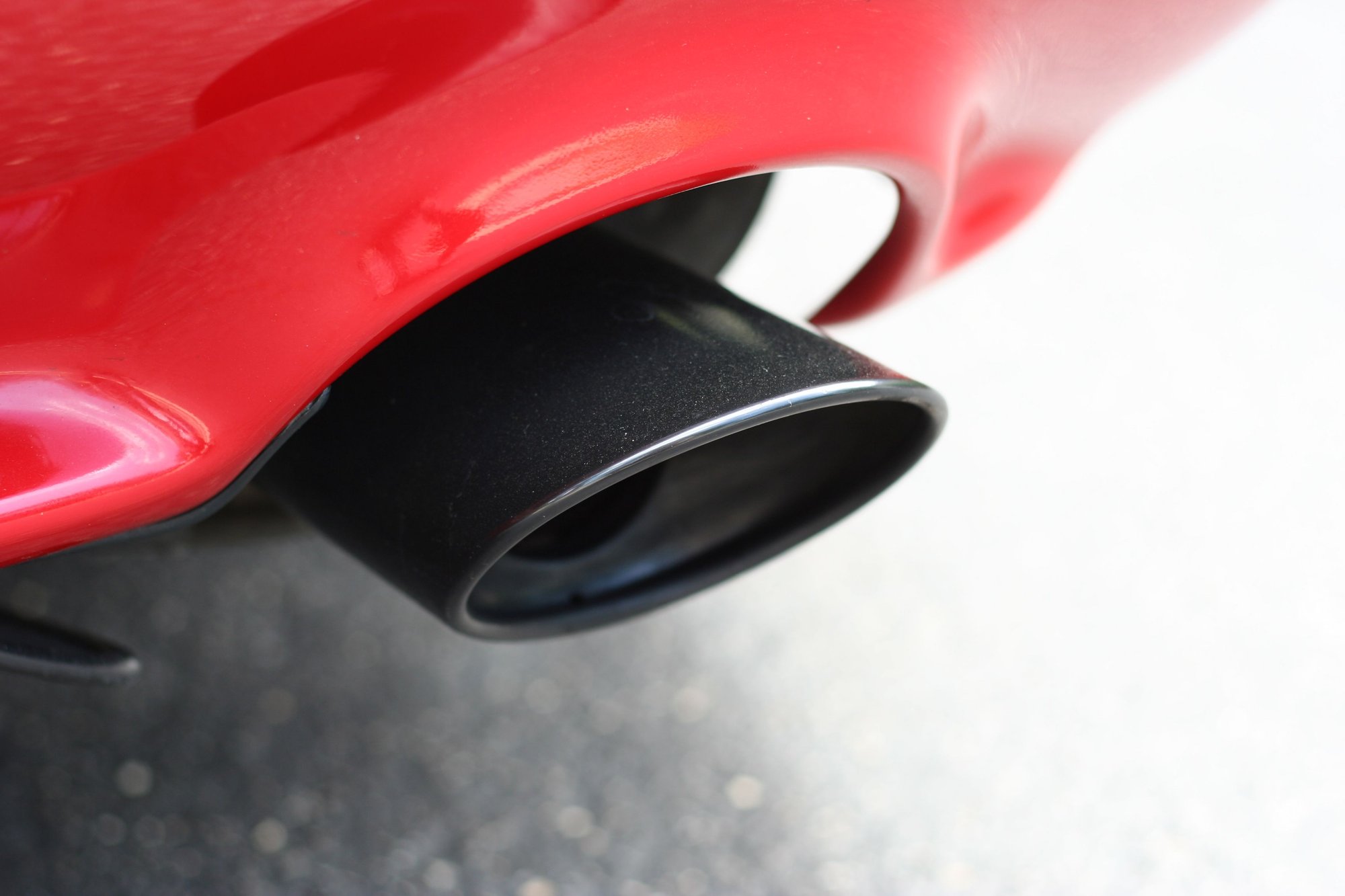

I changed my exhaust tips to Honda Crosstour when I saw that the angle cut on the Crosstour matched the angle of the rear bumper on the S2000 unlike the exhaust tips that are original to the S2000 which have a very vertical cut. Then, I powder-coated them semi-gloss black.
