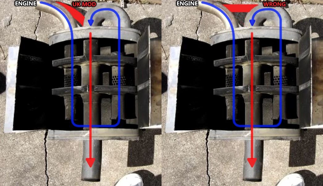

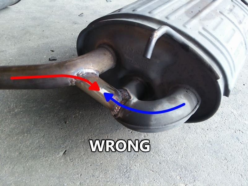

Try to do it so the exhaust flow doesn't fight itself.
Most muffler shops don't know the direction of the flow so they just make a random bridge that probably hurts performance.
