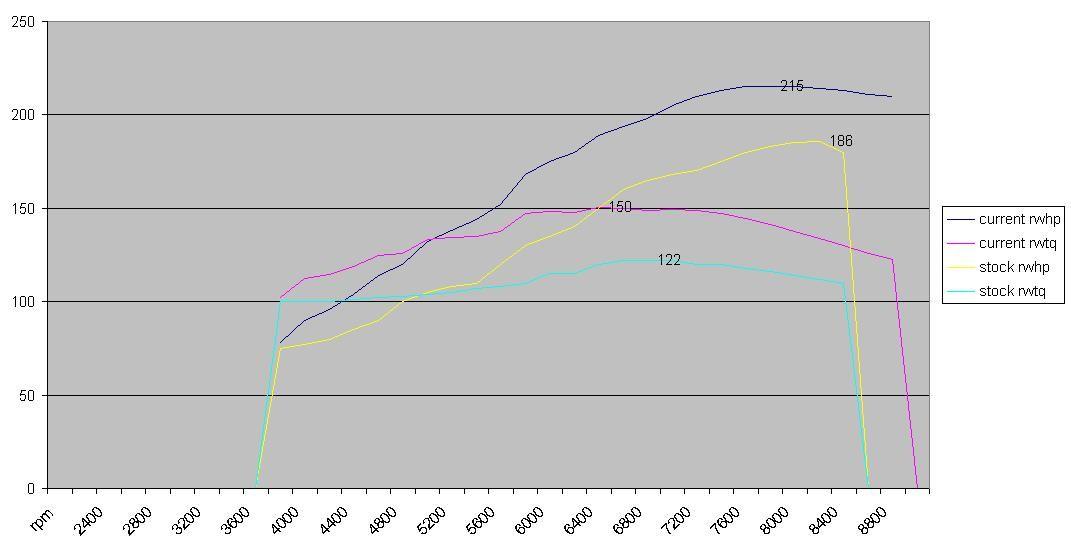

Stock: (mustang dyno)
Last time it dyno'd (Mase)
Total Delta. You can use your imagination for the range of error between the 2 dyno's.
Jenvey 50mm ITB's
SVT 440cc/min injectors
AEM EMS 1052U
Megan test pipe
