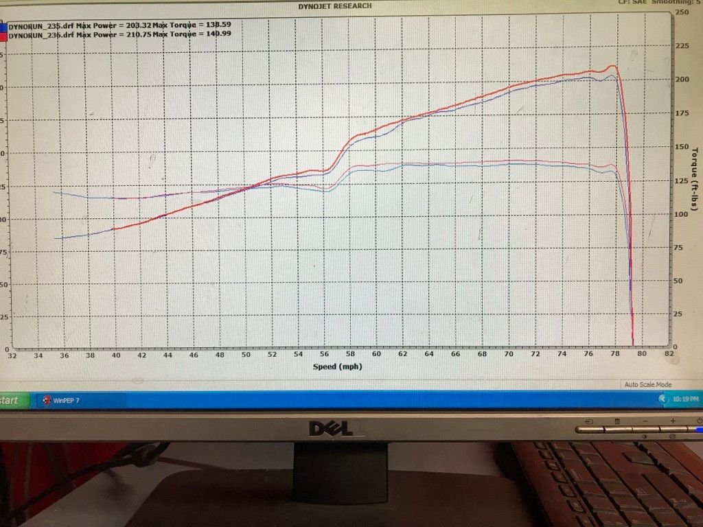

Their graph seems to indicate a pretty minimal change in output.
