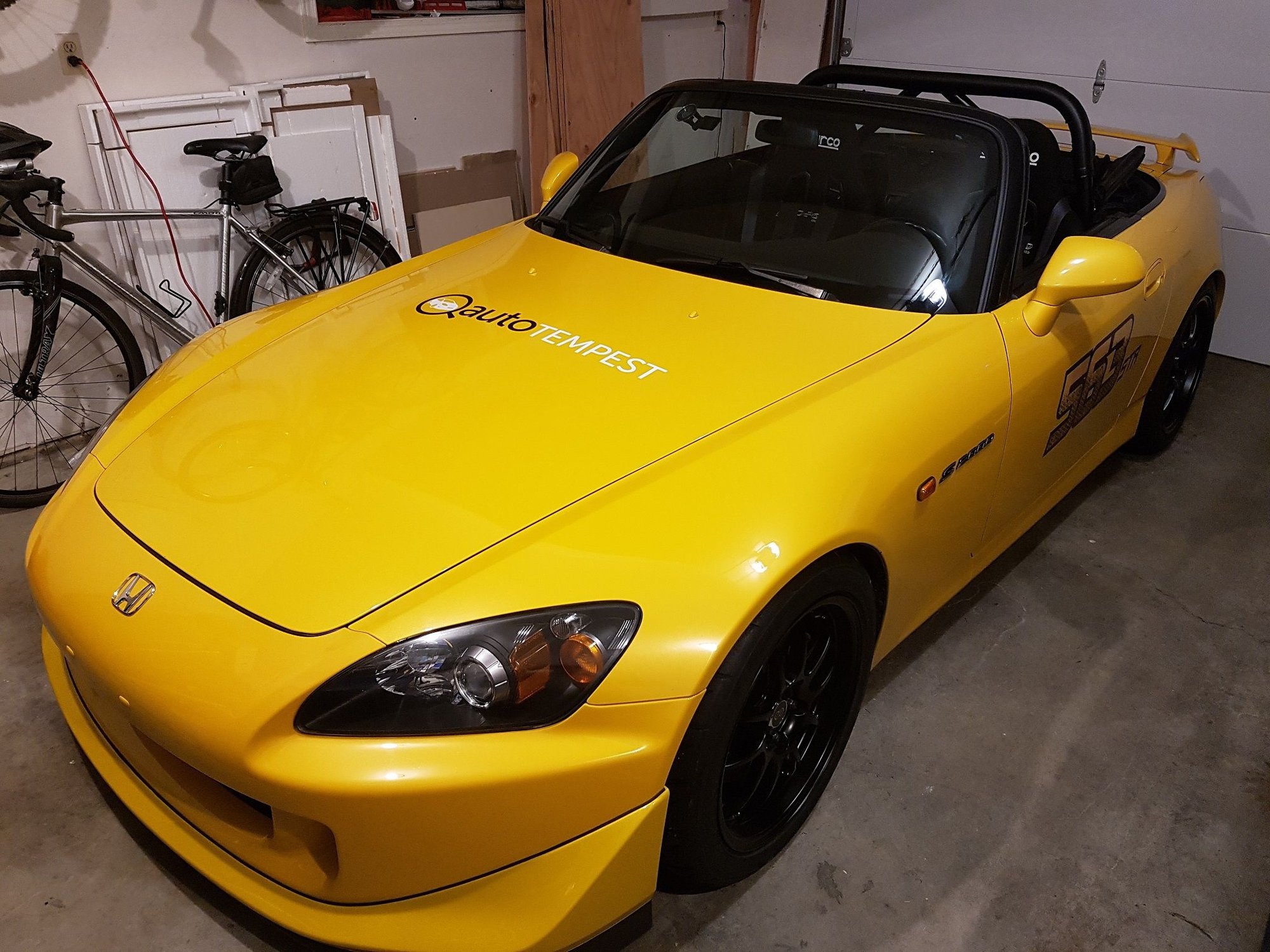

Literally just finished my build, so figured this was a good time to start the 2018 thread! As per last year:
Originally Posted by Marloon
Please share your 2017 STR setup
Tires/wheels/brake pads/rotors/shocks/springs/sway/alignment/ride height/intake/header/Exhaust/seats/db/weight/ECU/etc
Please note that this thread is only intended to share setups, STR development discussion thread can be found elsewhere.
Old Jan 1, 2018 | 01:57 AM
Nate Tempest's Avatar
Joined: Jun 2017
Posts: 503
Likes: 72
MODEL: 2006 Honda S2000
SUSPENSION:
  • Karcepts JRZ RS Pro - 750/550 Single Springs / No Helpers - Karcepts spherical upper mounts
  • Karcepts 0.250 Front Sway Bar
  • Karcepts 0.095 Rear Sway Bar
  • Stock Bushings
  • SPC front offset ball joints
WHEELS/TIRES:
  • Enkei PF01B 17x9 et 60 with Bridgestone RE71R 255/40/17 Square
BRAKES:
  • Hawk HP+ pads (from previous owner) on stock rotors
ENGINE:
  • Gold Wrapped K&N Fipk
  • Ceramic Coated PLM Header
  • Berk 70mm HFC
  • T1R 70R-em Single Exit Exhaust
ECU:
  • OEM - Tuned with Hondata Flashpro
SEATS:
  • Sparco Pro 2000 x2
  • PCI-Racing fixed mount passenger side
  • PCI-Racing sliding mount driver side
  • Schroth Enduro harnesses plus retained OEM belts
MISC:
  • Hard dog double diagonal rollbar with center storage preserved and mostly functional
  • CR front lip (SCCA SEB just confirmed this is OK under 14.2.F)
  • OEM AP2 rear spoiler
  • Shorai LFX36 Lithium Iron Phosphate battery
ALIGNMENT:
  • Front: Camber -3.5, Total Toe 0, Caster 6.1
  • Rear: Camber -2.5°, Total Toe 3/16" in
HEIGHT/WEIGHT:
  • 13" all around (measured from hub center to fender)
  • 775 FL, 710 FR, 770 RL, 710 RR – 2965lb total, including 170lb driver & 2/3 tank of gas
To Do List for 2018:
  • Possibly steering wheel. I really like the stock, but it's a process getting in and out with the bolsters on the Sparcos.
  • Actually drive the car
Thanks Marloon for the post template too! Your build is so close to mine, it made it easy.
