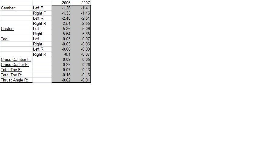

There are several posts for AP1 alignment, does anyone have suggestions for an AP2?
I track it a few times a year, but don"t autocross. The factory settings are giving me good tire wear, but I am looking for better track performance.

Here are my last two years of alignments. I favor the 2007 specs as they seem more neutral and less twitchy than my 2006 alignment. Since I also auto-x my S, you may want to consider others first.

Thanks, it wouldn't hurt to try your '07numbers. How did that work for general tire wear?

Are those 2007 settings on a stock suspension?
And were you auto crossing on slicks or street tires?
