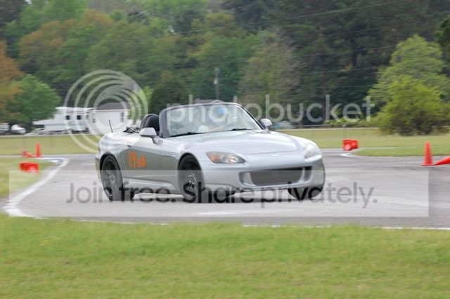

Almost lifting the inside Front tire:
I read somewhere on here about people lifting the inside rear tire in corners. That may have only applied to cars with slicks.

That looks very well balanced.,.what is the setup?
Originally Posted by engifineer
That is a long ways from lifting the front tire. It is light, but still not lifting. I have pictures of my Scion tC with the front looking like that, and I can tell you that short of hitting a curb on a racetrack at high speed you will NOT lift the front tire on that car in a corner
I think we are approaching lateral acceleration levels that could lift inside wheels. I think I've seem pictures of very stiff, lowered, STRs lifting both inside tires (air under both), but that may have been in the Hoosier era.
[/quote]
I had one where front right was a little light. Not lifting but light
At 1.5g in a right hand turn with no passenger the right side tires may have less than 200# on them. Depending on front/rear roll stiffness one of the tires could easily be unloaded.
