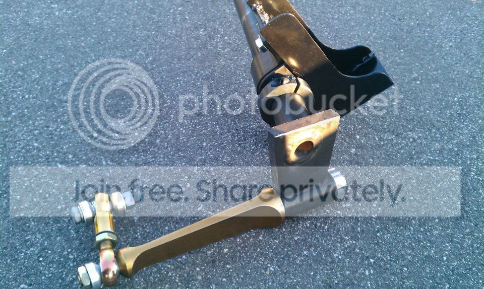

sorry for the misinformation, I have the 1.25" hollow bar with .25" wall thickness.
If you wanted, bars are available with up to a 2.43" solid center section with 1.75" 48 spine ends. The 1,25" bars are available turned down to .75" solid or .91" hollow or stepped up to stepped up in the center to 1.5". They would have to be custom ordered because the turned down/stepped up bars normally come in a 37.5" 49 spine configuration. I think ours are 36" 48 spine. I'm pretty sure this is the same for Gendron, Karcepts, and Arkeny.
A track car or a car at a multi-day event could conceivably change front and rear bars in addition to adjusting lever arm length. If they were done with out preload they wouldn't affect cross weight.
Generally though with current autocross formats where all the runs occur with maybe 10 min-20 min spacing those sorts of changes aren't practical. Has anyone made level arm length adjustments between runs?
Also, Ankeny bars don't use splined center sections.

And that type r character is a crazy one for changing the gendron between runs, if you ask me. I wouldn't recommend it. I suppose if you've done the exact adjustment before. But depending on the hole change, sometimes I have to take the end bar off. Not ideal for between runs.
[/quote]
[/quote]
agreed, wouldn't recommend it, it's a stressful experience. And your preload will be off.
[/quote]
Umm...he welds his end plates to the bar...so they wouldn't be changeable. I stand corrected. I wonder if he started as a spinded bar and he either cut-off and/or welded over the spine.
