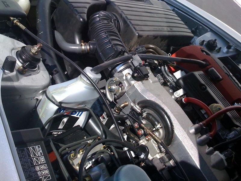

Originally Posted by Triple-H,Sep 14 2007, 09:26 AM
Any paticular brand?
Any paticular style?
A suggested place to buy?
Things to watch out for in selecting parts?
Things to watch out for during install?
Other clues that would be helpful?
This is the high tech catch can setup

LOL I've used water bottles too. except he's catching the wrong line.
Yep, wrong line. I need a larger bottle for mine... seems an oil bottle fits well there!
Crap. You're right. Why didn't I see that? I do get oil in collecting in the bottle though.

actually we're both right and wrong. you want to catch can both lines.
But you usually get more blue smoke from the other line.
While we're on the subject... Krazik, do you catch both lines? I only catch the PCV line and I sometimes fill my catch can after only 5-6 laps (namely at VIR where there are lots of decreasing radius right hand corners). Seeing that you run 30+ minute races, do you ever have problems similar to this? Or do you just run a sufficiently large catch can?
