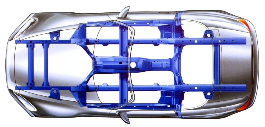

To start, Honda made quite a rigid frame!
You know I race an AP1 and I personally added quite a few bars...you have an 09 so there should be no problems I hope
