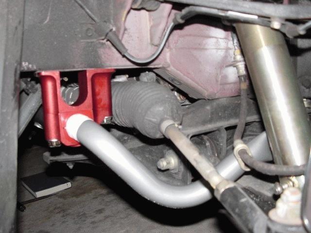

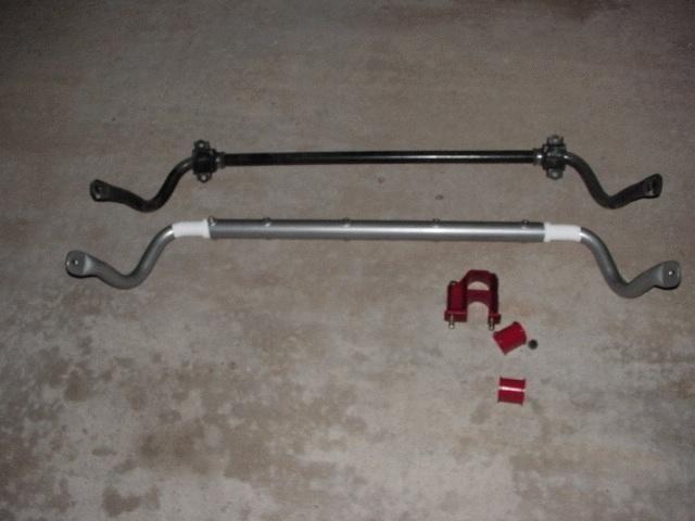

Right now I'm letting the (stock) exhaust cool off after a drive around the block with the new sway bar. Install was pretty straighforward; bar ends lined up with the stock pieces perfectly.
Old vs. new:
Installed:
