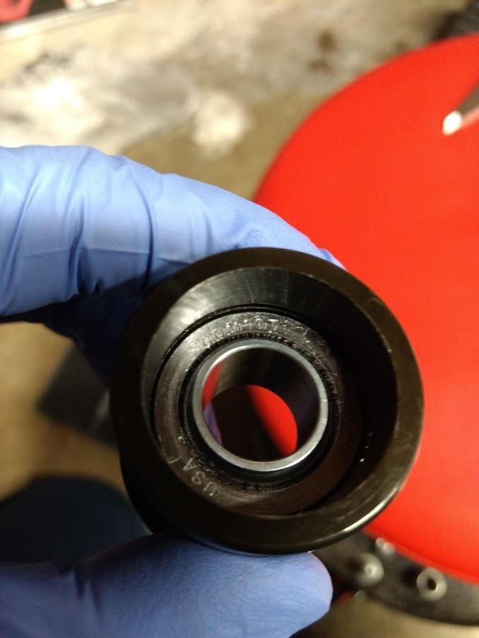

I contacted ESM and they have supposedly shipped out the x8 (4 per kit) that we were missing. We also discovered this slop in the spherical unit that we believe is part of the machining of the housing where the bearing itself goes into. We have sent an email to ESM to see if they can help us out on this as well as it appears to be a machining defect to the housing unit where the bearing is pressed in. We are anxious to get the kit together from ESM so that we can get to some product/car testing along with some exciting reviews of the ESM Race spherical bearings product.
Here is a video of the slop:
https://youtu.be/3soTpb3fTC8
side profile of the housing
the spherical bearing which sits inside of the black housing
side profile specs
length profile spec
We've encountered loose or sloppy bearings, from our experience they tighten up once they are pressed in.

initiald3s - It looks like the same thing happened to the both of us. Were you able to confirm which ones you were missing? I think I have seen your S at the track before (I was lurking...). Interesting screen name too... makes me wonder what other cars you have?
RogueMotorsports - It's just a little odd that those two were significantly looser (to a point where you could shake the entire unit and it would rattle). It seemed like the housing where the spherical was pressed in was more conical and not a consistent diameter. From the video, you can see how loose that bearing is inside of the machined housing. Any sort of movement would result in a clunk (whether it would be audible inside the S or not) and any sort of rotating would be done by the 'bearing inside the housing' and not of the spherical bearing itself. I appreciate your comments, but with how labor/time-intensive swapping sphericals to our race cars are, I just didn't want to chance pressing in something that is not consistent to begin with, doing an alignment, and finding out that the play was too excessive and having to down our cars again and repeat the processes. Let's hope it all works out though!
If ESM Racing takes care of this, and the product works out, I have no problems sending more of our cars to use their products. Hopefully everything gets to us in a reasonable amount of time. I'll keep everyone updated!

We received the x8 missing sphericals for the front upper control arms (we ordered two kits), and have received one of the two housings/bearings for the sloppy units (the new one is tight like it should be). I just followed up with ESM on the last remaining sloppy bearing unit replacement though. I'll continue to keep everyone updated with receiving the last spherical bearing, and then onto the install of both of these kits.
