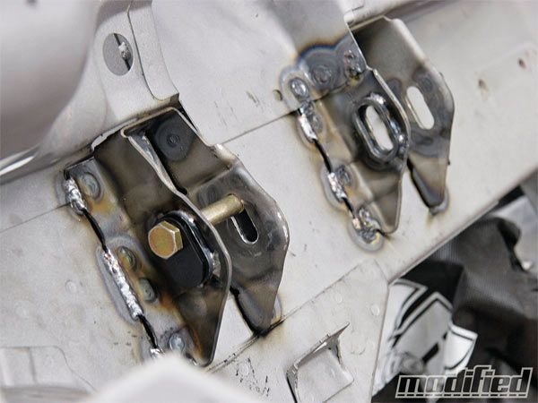

When Andy Wojteczko prepared his S2000, he modified the upper mount with a slug (common on oval track cars) that allowed the inner pivot to raised, helping the geometry in a lowered car. He then added the Spoon reinforcement.
2000 Honda S2000 - Adjustable Geometry, Optimum Handling - Project S2K - Modified Magazine

Is it just me or do those welds look horrible?
Bigger the glob, better the job....
It might just be you. Beautiful even heat marks showing great penetration.

Those welds looks fine
