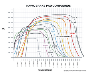

Hrm, it doesn't look like they make the 50s for the the S2000, or at least don't list them on their site. I see the 30, blue, and ht10. Maybe the 30 is a good choice for the rear judging by the heat ranges.
I'll repost this since it always helps:

I would've thought the newer DTC 50 might be the ideal brake pad for an S2000, however Hawk does not seem to have them for on the calipers. The PFC 11 to be comparable if not slightly superior. They are available for the front caliper apparently doesn't have them for the rear caliper. I have no real knowledge of any of the other brands.
