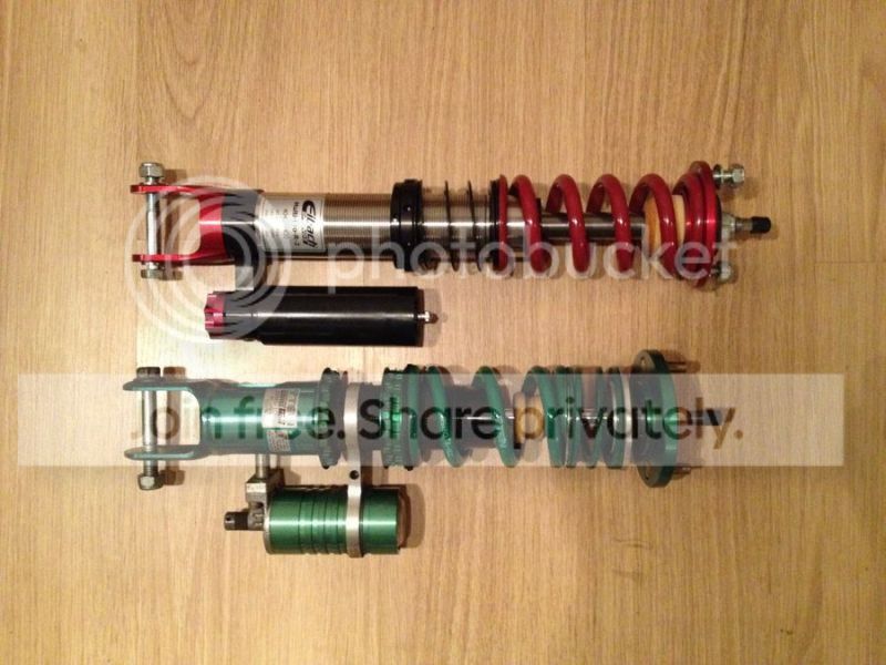

My R2's came with the helpers on the bottom, but I know others were sent with the helpers on top. There was an issue with the adapter collars (in between the helper and main spring) wearing on the shock body. Daryl at Evasive didn't like Eibach's O.E. helper set up, and had a custom Swift setup made with a much higher block height, give him a call maybe.
My R2's versus my SRC, and R2's installed:
The SRC has the helpers on top...
I installed 6" springs on my R2's, and I think they're really too short, I'm switchiing to 7's.
O.P., No harm in switching yours to the bottom just to see how it does.
