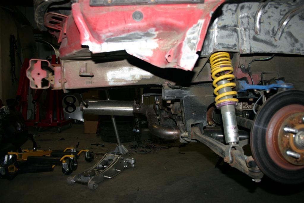

I have been running KW Comps with 900 front and 950 rear springs.
I think
