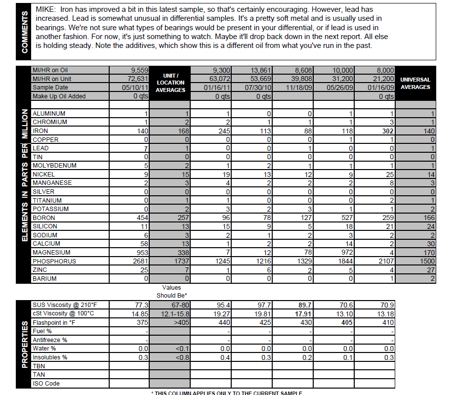

My last diff UOA
Last sample is using Motul Gear300 LS.
Previous 3 are LE1605.
