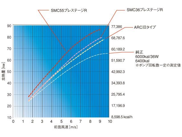

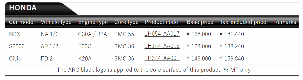

ARC makes a direct drop in micro tube radiator, but it's not cheap ~$1,270, it's thinner than OEM and 25% more efficient.
https://www.nengun.com/arc/super-micro-radiator?country=US&gclid=Cj0KCQiA2snUBRDfARIsAIGf pqFawu7QtkWcWTm-yQRwFJusPywgpW-s_hZy1E4Y-OaemHYOP6iRjqAaAhOOEALw_wcB

They list an off-the-shelf radiator for an S2000. But the underlying question would be why. In F1 and Indycar the radiator is a key part of the aerodynamics because of its significant impact on drag.
