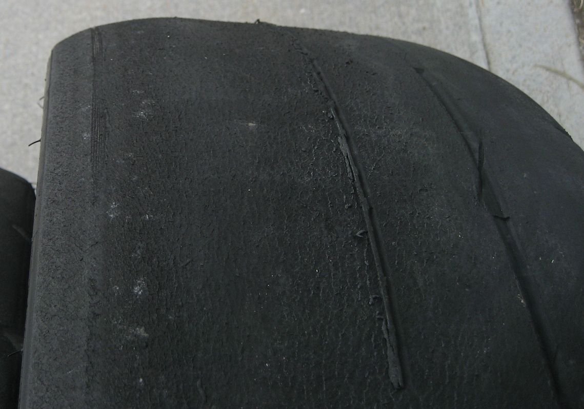

This is after about 730 track miles. The tire is a Nitto NT01 245/45 on OEM 04' front wheels.
I have -3 degrees of camber up front, but the tire is pretty streched out on the wheel. Do I need more camber, or is it just a result of the strech job?

Is the inside of the tire on the left?

sorry, left side is the outside.

how can it be stretched on oem wheels? Aren't those 17 x 7 1/2

Its more like pinched, but trust me, they fit.

Anyone else tracking 245/45/17 on OEM wheel with this problem?

I just recently am going to try 245/45/17 on 17 x 7 1/2 and 275/40/17 on 17 x 9. I havent started tracking yet on them but will let you know. I am having a bit of problem with clearance in the front. The rear is ok. I had to raise the car up 1/4 inch and will see.

You need more neg camber. Try -4
