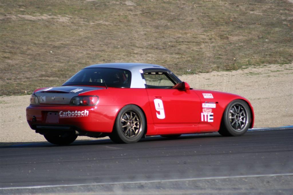

I have 2 sets of wheels for my car
1st set is 4 AP1 rear wheels running 245's
2nd is Volks 17 running 275's on all corners
I am not running a rear sway bar and a mugen front bar.
they will fit on a stock car but you have to roll the front fenders.
