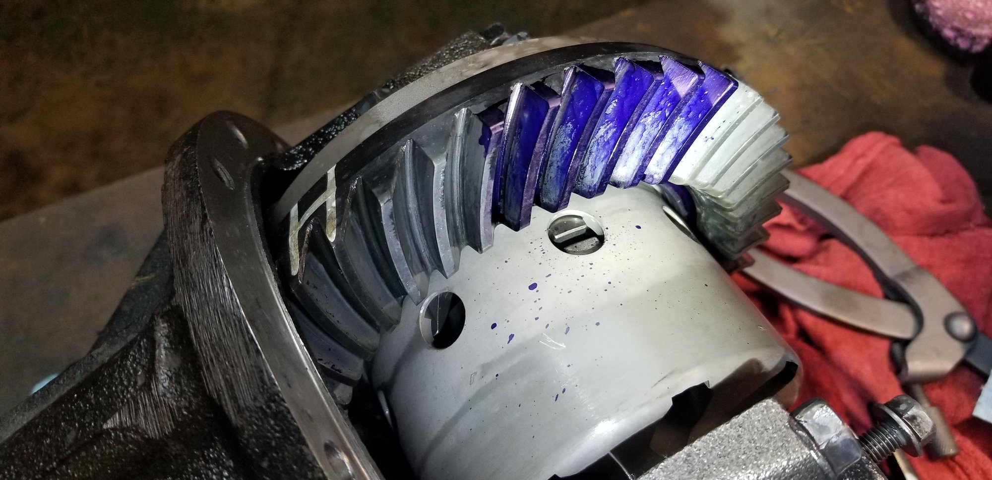

So I went to install the diff as a drop in. I set backlash to .0025 and went to check gear mesh and this is what I got. I'm certain this is probably not usable so I will tear the whole thing apart. If what I am reading is correct I need to change the shim size between the pinion gear and bearing? Does this mean I need to press the bearing off every time to change shims?
Also, how tight do the side screws need to be? Information on that wasn't super clear.
Once this is in and tested I'll try to do an in depth review on what changes you can expect.
Thanks again!
Maniac
Yup, looks like your pinion crush tube is beginning to start its self destruction mode by pulling the pinion away from the ring gear. When you pull the pinion check the underside to make sure there are not cracks. Maybe get it checked out by a machine shop to have them put the special dye to check for micro cracks.
