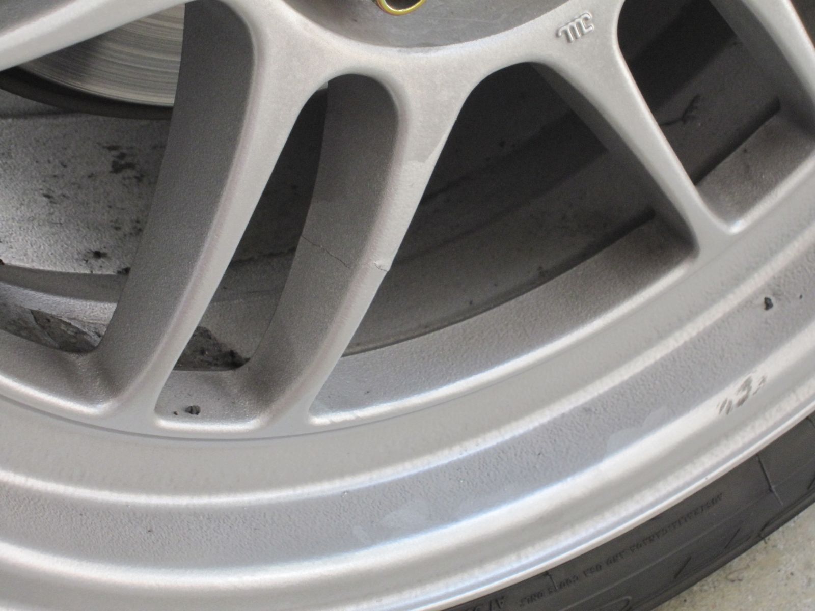

I have some airplane stripper that Ill use to make sure its not just the coat that cracked.

f20kills Posted on Aug 22 2009, 10:07 PM
IOW: do you confirm the spoke cracked?
Is this bare alloy we're looking at?

I havent confirmed yet.
That pic the rim still has the powder coat on it.
Old Aug 23, 2009 | 10:38 AM
  #60
f20kills's Avatar
Posts: 4,695
Likes: 13
From: Mom!!! The Meatloaf!!
Yup..its cracked
