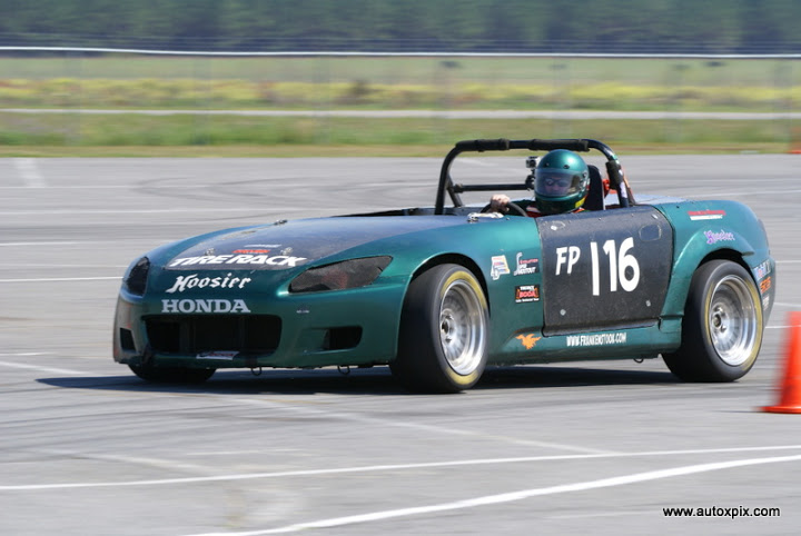

Do all the STR/BSP weight savings stuff
Replace: front fenders, hood, trunk, mirrors, and brakes with something lighter
Replace stock fuel tank with a fuel cell
Remove all sound insulation from hood, washer bottle & nozzles, hood latch & hinges,
Add: bigass wing & front splitter, traction control
If my math is right, minimum weight for an SSM-legal F22 would be 2311, and an F20 would be 2279, which should be achievable.
