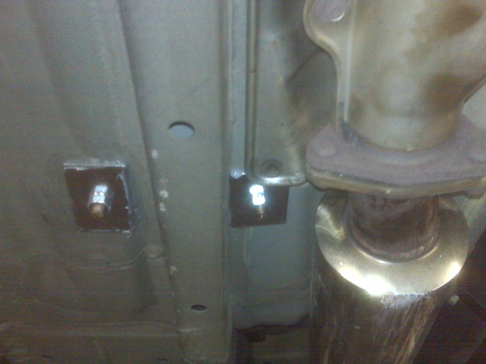

Passenger sub belt mounts. Ideally you want them 4" apart. this is not possible on either side of the s2000 unless you want to flatten sections of the floorboards. I didn't, so i settled on 5.5" apart.

drivers right side is right under the fuel lines. BE CAREFUL. I put a vinyl sleeve (slit hose) over the fuel line that was closest to the bolt so it didnt rub.
drivers left side
Make sure to seal the backing plates with silicone to prevent water seepage. Also use high strength thread locker on the sub strap eye bolts and lap belt bolts.

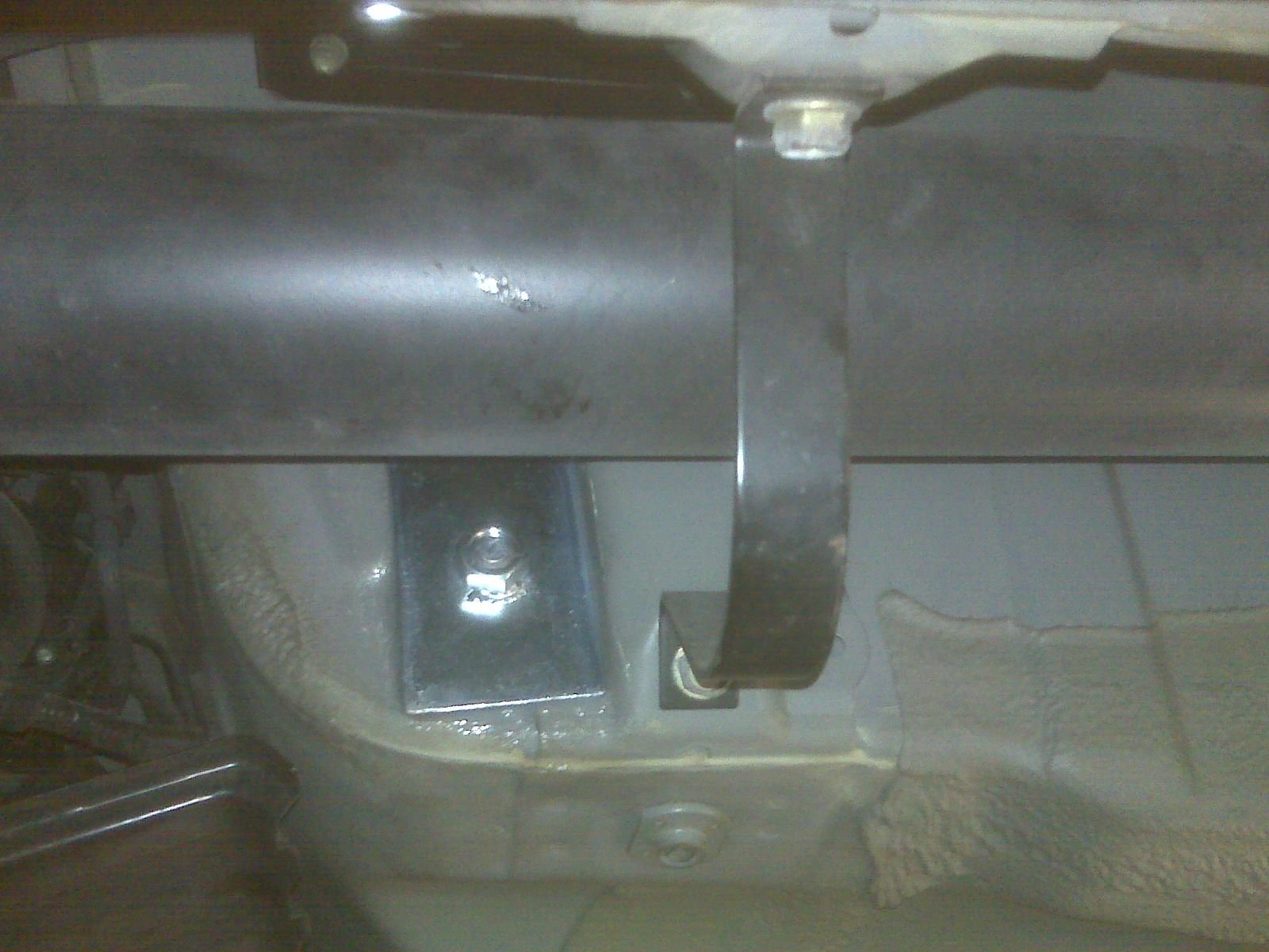

Do you really trust this "eyebolt" shown below? What is it made out of it looks extremely flimsy to say the least.

And yes I absolutely do. Schroth pretty much makes the best harnesses out there and this is a schroth eyebolt/bracket specifically made for clip-in harnesses. Its designed to be bent in one direction only and as long as the vector of force is in line with the long dimension of the bracket, I think its very strong. The referenced schroth manual has a section on how to mount these types of brackets and the ways in which they can and cannot be bent. HMS Motorsport knows this hardware very well, and this is what they recommended for this application.
note: these brackets are the "Schroth B23A bracket installation for snap-on use" PIN 01234 -- from the box they came in.
The other thing that would work is the tunnel mounts from Brey-Krause. These are made for Porsches but this would work in a S2000. These cost about 3x as much as the Schroth but permit the factory seat belts to stay in place.
