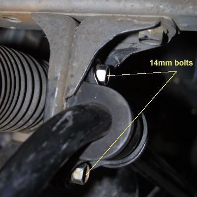

4) loosen the 4 14mm bolts (2 on each side) that hold the sway bar brackets to the frame. Do not remove them completely yet.

6) Remove the 4 14mm bolts from step 4. This will completely release the bar. Take it out and set it on the ground. You will not be reusing the bolts.

8) Put the metal collars on the bar loosely, grease the bushings and place them on the bar, and fit a bracket over each bushing. Place one of the new 14mm bolts through the top hole on the bracket and then through the spacer plate. This will allow you to lift the whole end into position and start the bolt without having to line everything up individually.
9) Lift the bar into position and start all 4 14mm bolts. Do not tighten these down, as you want to be able to move the bar around some.

12) With the endlinks in place, tighten down on the 4 14mm bolts and the 3/16ths inch hex screws in the metal retaining collars. Make sure the collars are snug against the bushings.
