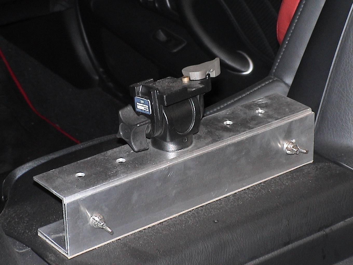

The mount is made from 2" aluminum angle and few machine screws. Takes an hour to cut drill and screw one together... I added a tripod mount to make attaching the camera easier and a few extra holes for mounting more than one camera.
The camera is a Sony TRV30 Mini DV camcorder with a wideangle adapter.

Thanks for the look at your setup. We don't have a windscreen installed on the 2000, so I guess we'd need to drill some holes to mount it like you've shown. Hmmmm need to consider more options.
