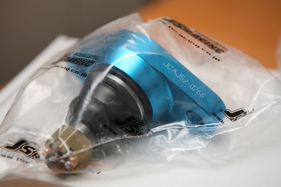

Those are preeeeeety!

Haha, it helps that I took it with a 5D and 24-70L with a strobe. But seriously, I heard that Aaron's S2000 suffered damage possibly because of a design flaw in the SPC kit, and I especially don't like news of people's bolts slipping on them (hence the perpendicular fix). If all you need is more front adjustment, I'd take the J's anytime. Unfortunately, I think SPC is the only solution for the rear.
