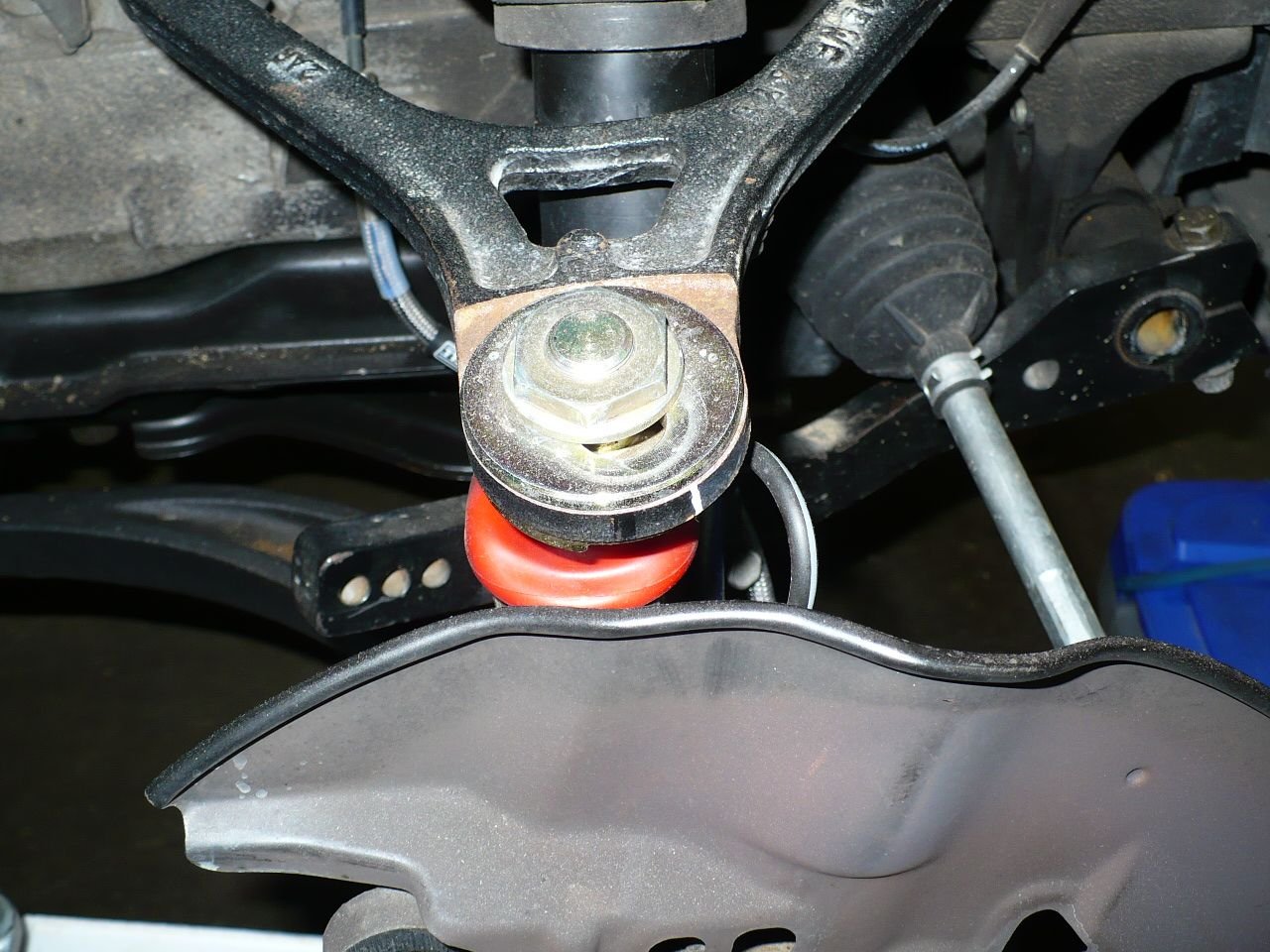

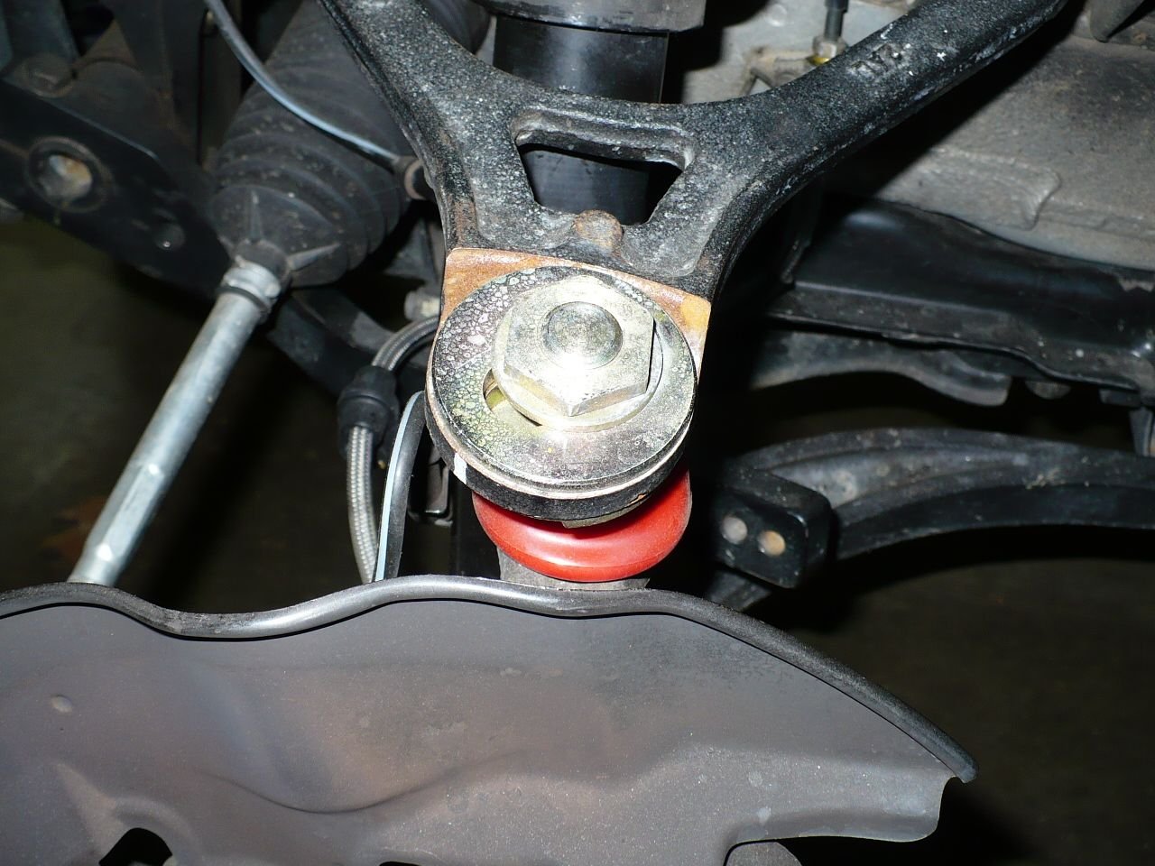

Not sure how many of you are doing this, but I installed my at an angle such that I could increase caster as well as camber. Picture isn't the greatest, but if you enlarge the it, you will see the angle is not aligned with the control arm.

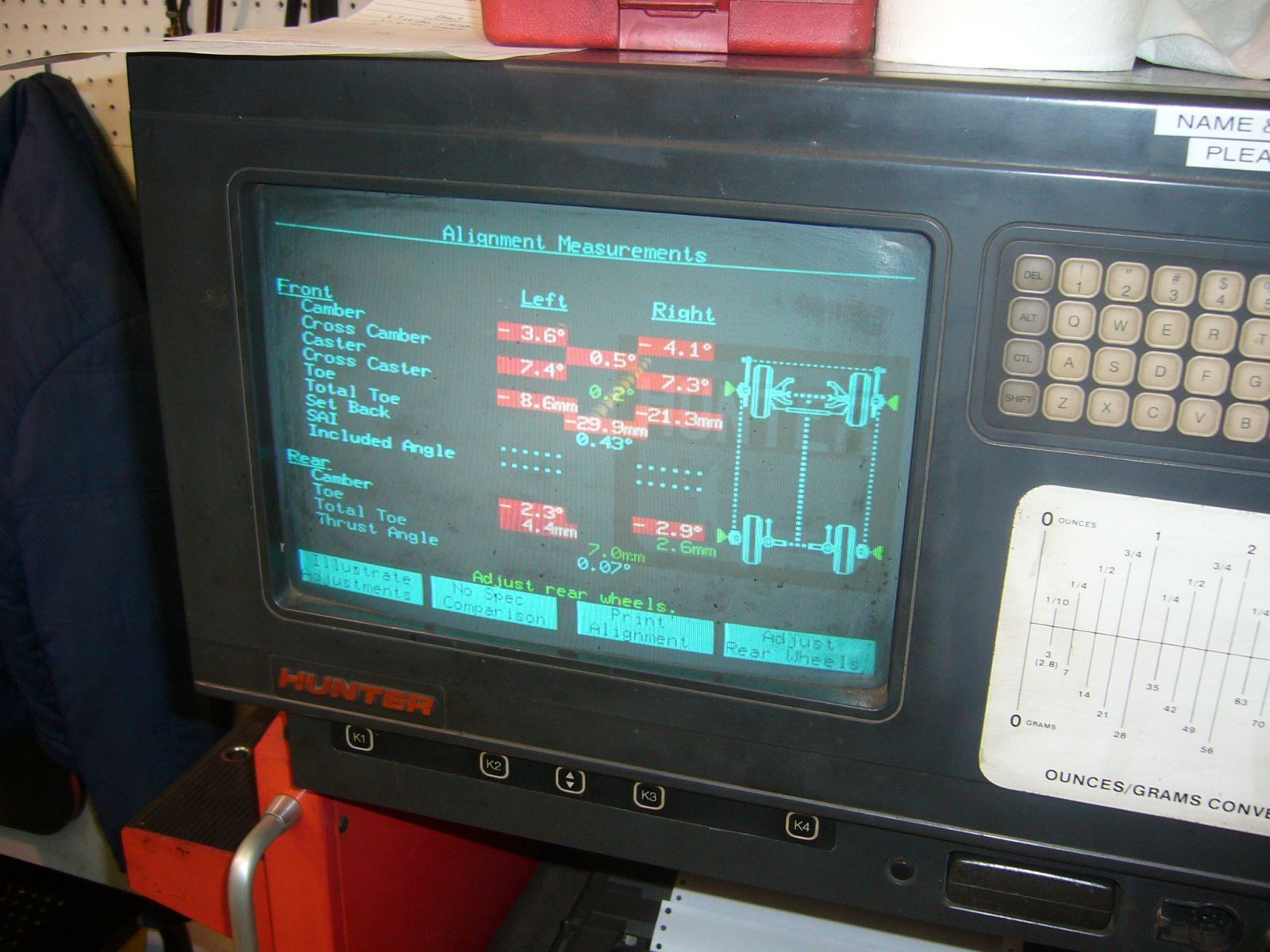

This is what I got before alignment.

I didn't think to try that, but I was able to get 7 degrees of caster with the bottom plate installed normally, and -3.5 degrees of camber.
That's cool, Bryan. My car was caster-challenged even after replacing control arms, hence my attempt.
