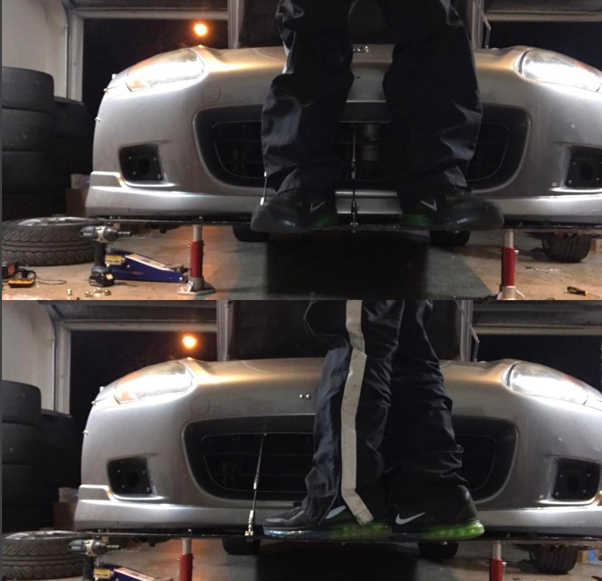

Originally Posted by RussianHammer
@rioyellows2k
Does your Polymetal splitter have any flex or does it wobble around. Or is it a solid panel due to the aluminum sheets?
The panel is rigid. But it will obviously flex modestly if left un supported since it's a large structure.

I can confirm that the Chinese Amazon splitter support rods are crap. I had one break in my hands when I was just bolting it on. Longacre rods should arrive today.
I was able to use rubber well nuts with some spacers to mount to the subframe drain holes at the rear of the splitter.
