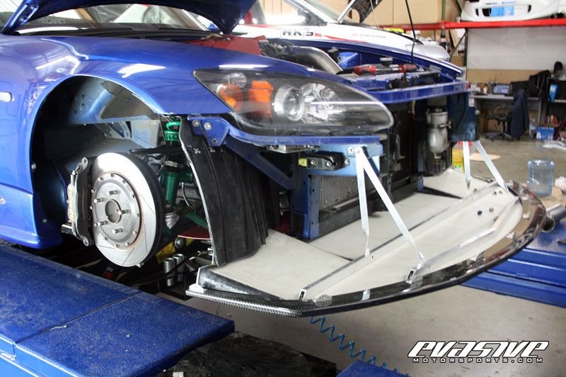

1) For race/track S2000s, when fitting a front splitter, was front diffuser design and air exit path from the diffuser an important consideration or a consideration at all? This is a picture of an Evasive-built car's Voltex front splitter; the diffusers are visible on either side. As in the rear, the purpose of the diffuser is to increase the speed of the air under the flat section in front of the diffuser, reducing its pressure and increasing its downforce (or reducing its lift). A diffuser exiting into the wheel well would require the wheel well to have sufficient air exits to prevent pressure build up. Some prototypes now seem to have the top of their fenders cutout.

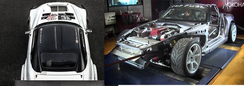

2) Was ducting placed before and behind any radiator, oil cooler, or intercooler to force all incoming air into the heat exchanger core and to seal the air flow exiting the heat exchanger, ducting it into a low-pressure area. That low-pressure area is usually near the front of the car behind the leading edge of the hood and well in advance of the windshield. These are pictures of the Top Fuel S2000 time attack car, showing the radiator and the hood exit. Cooling airflow is a significant part of the car's overall drag, and it can also affect downforce.

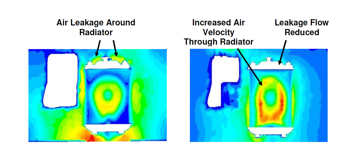

This is a CFD of a small Indian van which was being analyzed for increased cooling efficiency.

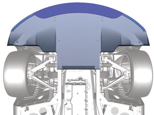

This article about the Viper ACR's front aero also provides some insights: Composite wing key to high-speed stability https://www.compositesworld.com/arti...ability#.WerFU
The article says the front splitter has 7 distinct diffusers. Additionally, they used canards which the article says created vortices that helped extract air from the wheel wells.
