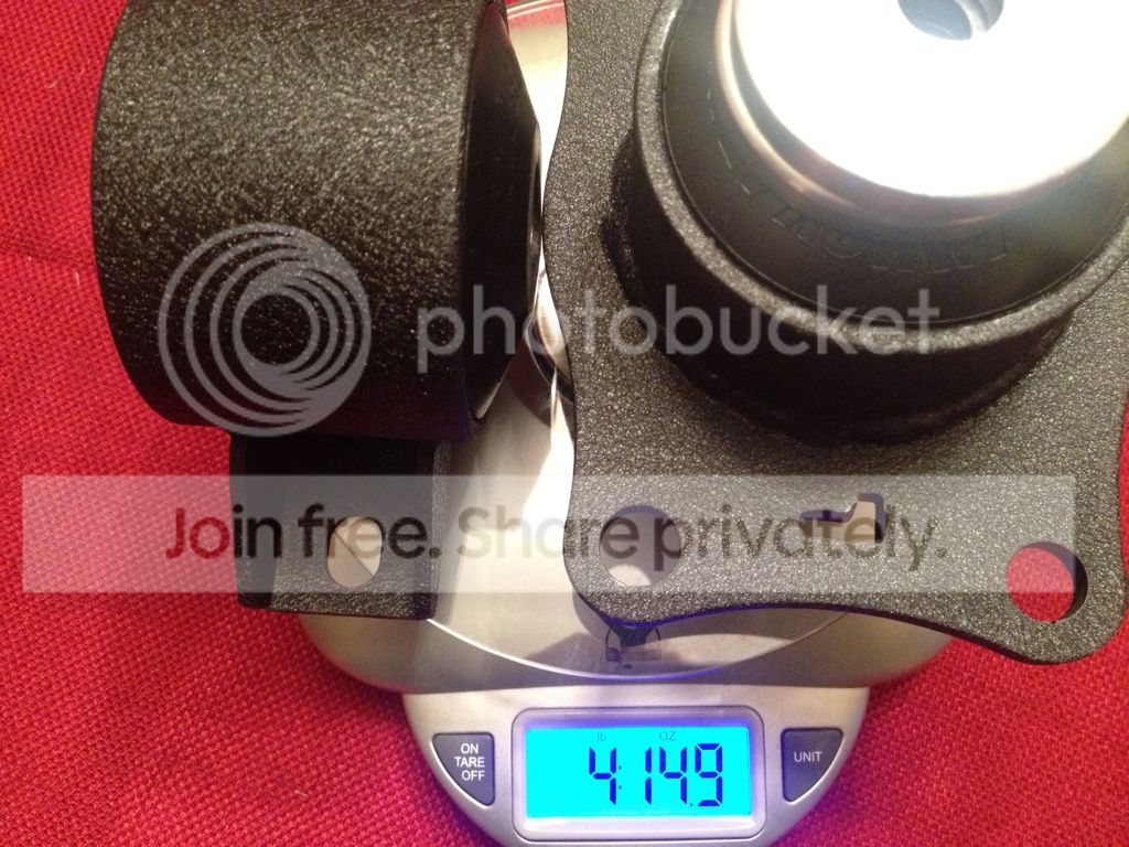

So did we all come to conclusion the inovative diff mounts are legal? They appear to have less metal then the stock ones.

Originally Posted by josh7owens
So did we all come to conclusion the innovative diff mounts are legal? They appear to have less metal then the stock ones.
I would have been debating for the innovative mounts from a compliant material perspective under the 2012 and prior rule (which was very poorly written), but that is a mute point now with the new 2013 rule where the steel innovative mounts clearly meet the rule because they weigh more than OEM. If the innovative billet aluminum mounts weigh less than OEM then they would not be legal. The two lower bolts and the bushing bolt should be included in the weight for the innovative mounts because the OEM ones have the lower studs built in and they do not have a through bushing bolt like the innovative.

Does anyone have the weight of the OEM ones?
Driver side is 5lb9oz and passenger side is 5lb10oz. This is for the assembly (aluminum, rubber bushing, and nuts on the lower studs).

Old Jan 3, 2013 | 10:37 PM

From: Frankfort, KY
Stock Diff mounts are 4 lb and 5 oz per side
Inovative Mounts- 4 lbs and 15 oz (10 oz heavier on each side) STR legal!
