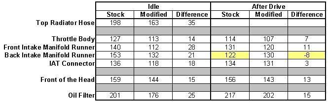

The temp measurements that we took are posted below. The differences we measured were primarily in the cooling systems, not the oil.

Thanx for the chart, I never saw it posted. Notice that the differences in temp differences are much lower after the reasonable hard drive due to the fact that the cooling systems could actually do their job. We never really taxed the systems to the limits which is where you would see the most differences due to air flow &/or system efficiencies. What happened to the radiator hose temps after the drive? Did we forget to take them or could you just not read them?
Now we need to do it again after I add the low temp thermostat. That will more clearly show you if there are any negative effects to the Hondata Insualator.

We didn't measure the cooling system temps because both our fans were off, which indicated that both of our systems were fully "cooled". We should have verified it, but I'm sure that if the cooling systems were above the 163 or 198 marks, the fans would have been running. The only temps that really went up were our oil temps.
