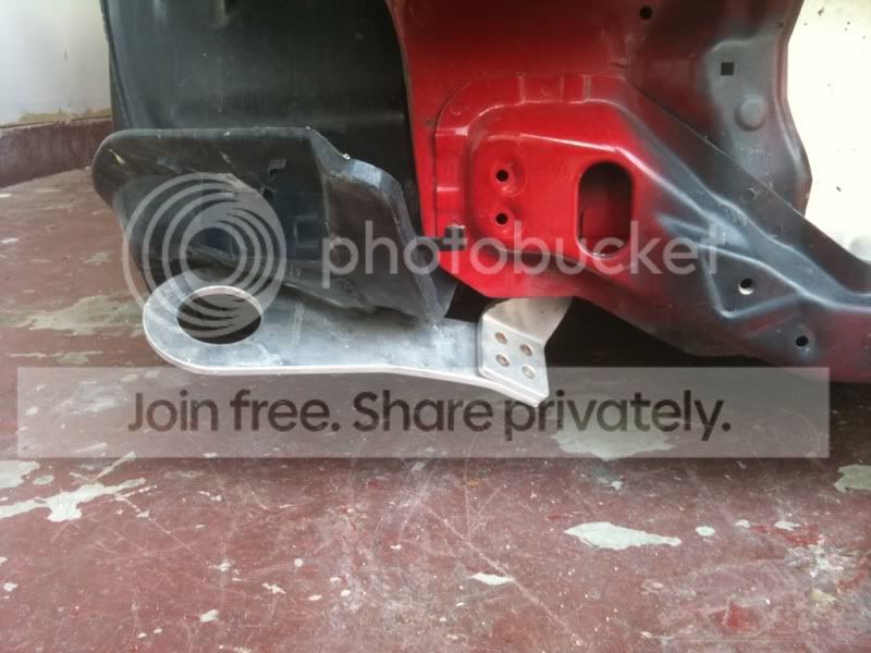

If you use a strap through a slot in the bumper you'll need a lot of clearance for the strap as its getting pulled from different angles, I think a better solution would be to use a stand-off and bolt to that so the entire piece is clear of the bumper skin.
My brothers tow hook after Ringo pulled him off a while back:
